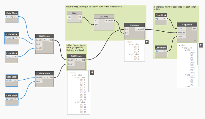

I’d try to get one list of rooms, grouped by Building and Level, and then sorted by XY position.
Then generate a sequence of numbers 0 to nn for each inner sublist (to give you the RoomNumber). I’d use a Double-Map technique as shown, but that’s increasingly unfashionable.
Finally format and concatenate the strings for each room, and SetParameter.

Bardur,
I was intrigued by the two-level Group (by Building and then Level), so I had a go. Seems to work OK.
I’d sort the rooms by XY before grouping. Grouping shouldn’t re-order the elements within each inner sublist. And it’s easier to sort the flat list.

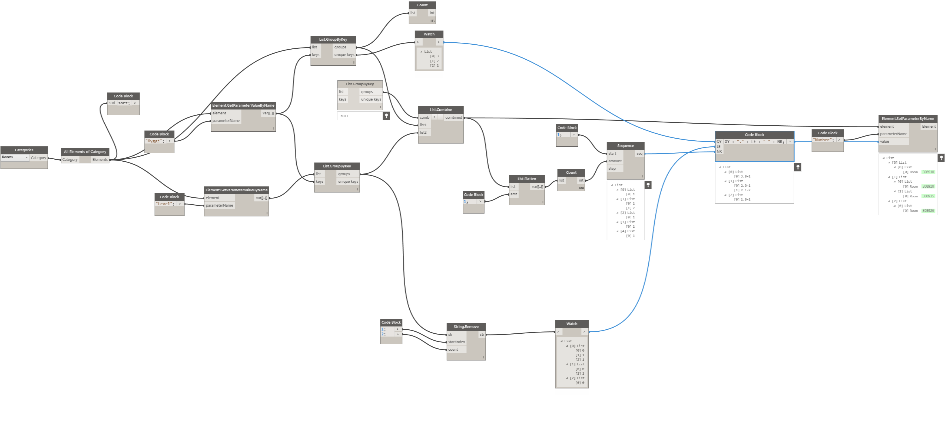

Here is a complete solution.
Lots of scope for further refining and improvement though.
File: RoomNumbering.dyn
Revit: RoomNumbering.rvt
![20160515-4](http://dynamobim.org/wp-content/uploads/forum-assets/testingwaters/05/15/20160515-4.png)
Hi Vikram.
This is realy good stuff, very usefull and very helpfull to understand somethings in dynamo.
Our buildings have number in a parameter, so that part was not so advance as your solution.

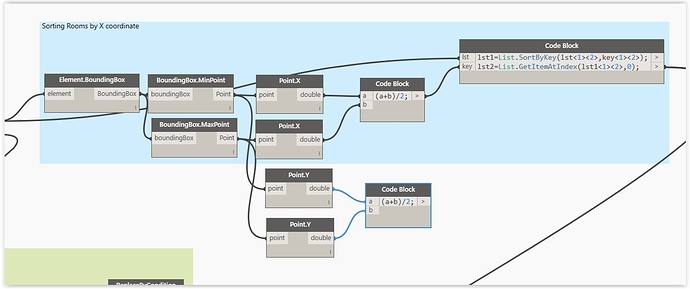

In my dynamo program i got all part except to renumbering by x coordinat. And that is important.
Thank you very much for all your help.
It works perfect.
Hi Vikram.
I love this “number” program. I have used it very often.
But often there are room that will get the same X.point.
Something like this:
if(x=x, y.point, x.point)
Hope you understand my question?
Bárður
How can I sort them accordin to y.point.
