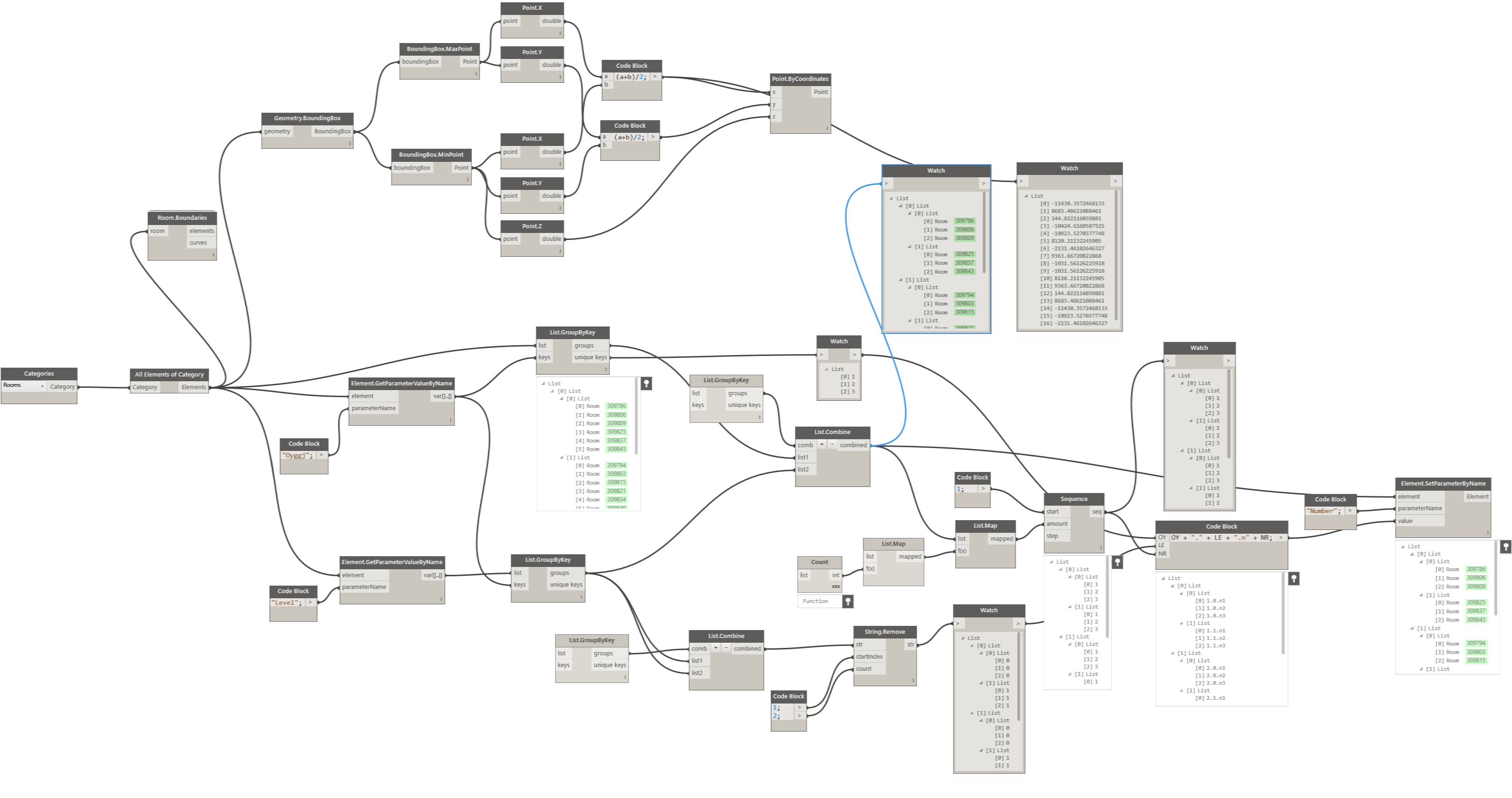

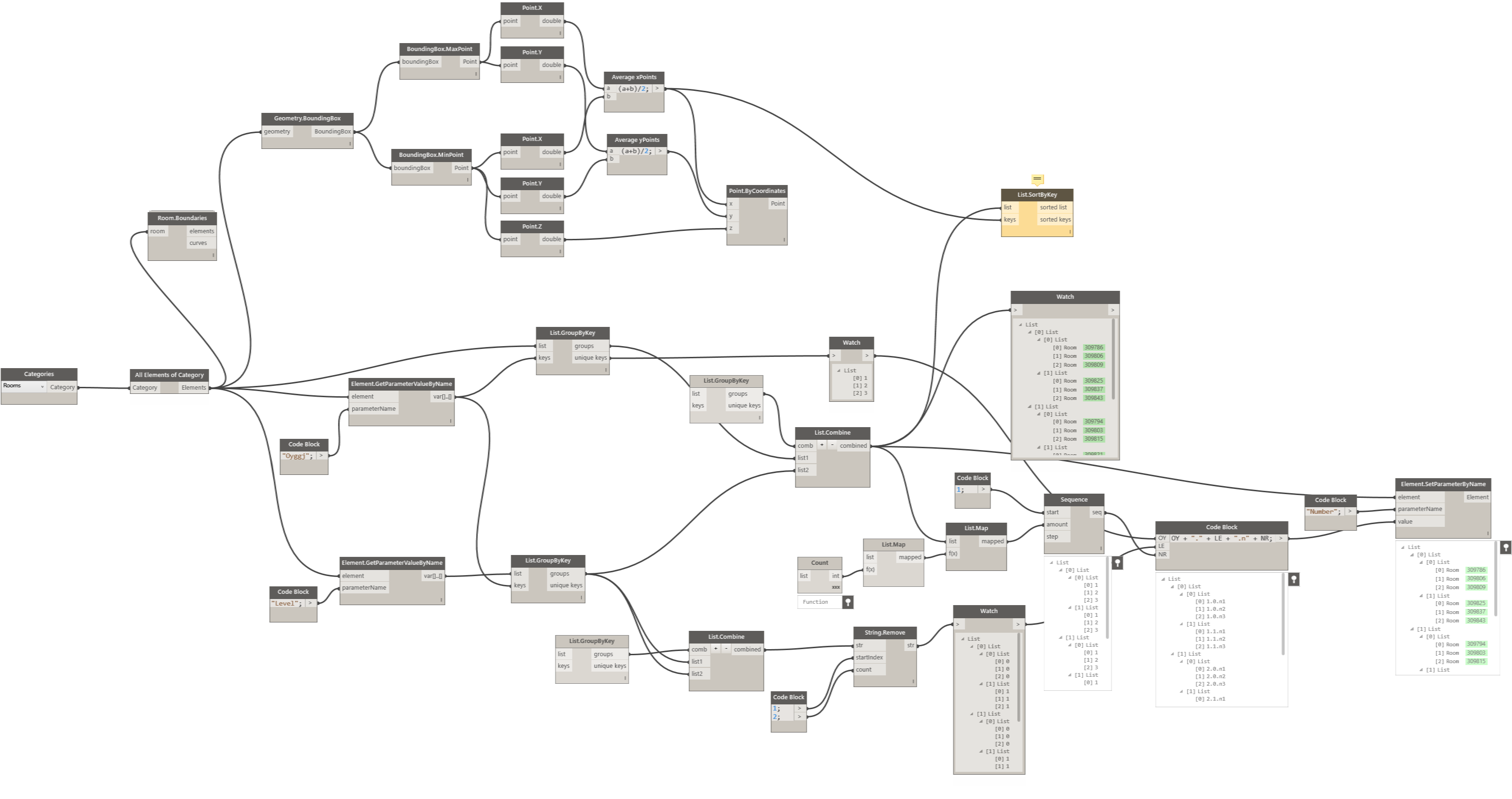

Hi Vikram.
I have try that and it works when i got 1 list.
But when I got lists in a list(it this called sublist?) I can not get it work.
Se picture. My list(problem) is the list with green number inside.
Assuming that the list and key have similar sub-list structures, instead of using the List.SortByKey node, in a code block type List.SortByKey(lst<1><2>,key<1><2>); and feed in the list and key.
You might also find my post in this discussion helpful.
