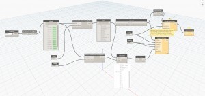

Hi Prasanna,

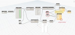

Your using string. Try Replace with number and also your lacing needs to be shortest. See below screenshot. Hope it helps.
Hi KulKul, Thanks for spotting out the errors. It might also be an issue linked with earlier versions of MSOffice.
Yes, It could be that also. Use MSoffice 2010 or earlier ![]()
