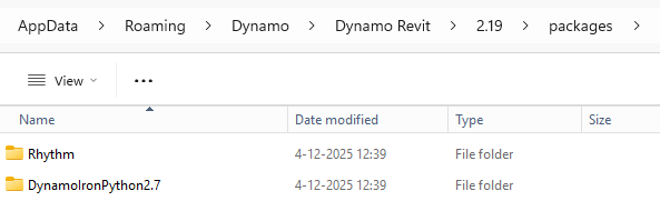

I made a button that copies packages from a shared location to the users roaming folder.
I tested it for Revit 2024.
For most packages it seems to work except for Rhythm and DynamoIronPython2.7.
This user has never used Revit 2024 before
(and Dynamo).
This was after the copy action :point_down:.
Is there a workaround?

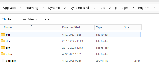

If you do a copy action for Rhythm, you need to make sure that there are no DLLs in the bin folder, except for the ViewExtension.
Rhythm loads the correct DLLs on the fly when Dynamo is opened, so if you are pushing those DLLs out, you are giving them the wrong version potentially.
Download the latest version of Rhythm from the Package manager website directly and put that in your deployment folder.
The folder should look like this that you put in your deployment location:

I copied all the packages from folder A to folder B.
Then i tried running the .dyn from the toolbar.
When the .dyn didn’t work i openend the .dyn in Dynamo and saw the :cross_mark: behind the
IronPython package (and Rhythm). So i assumed they didn’t load at all. Didn’t do anymore troubleshooting (yet), so i don’t know if there any warnings :see_no_evil:. I hope getting the packages to load solves everything.

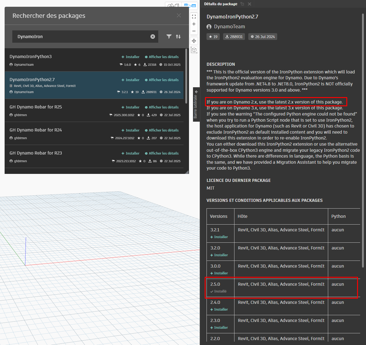

As Revit 2024 works with Dynamo 2.19, you will need to install version 2.5.x of the DynamoIronPython2.7 package.
  1. I deleted both packages.
  2. downloaded the forementioned packages.
  3. unzipped them and placed them in the right folder.
They are still not loading and also not showing the correct version?
So i am looking good for a solution for reliable
installing packages manually.
The package manager is the reliable solution for manual installation. :wink:
The hard part is getting the right package for your Dynamo build.
Revit 2024 is the last Dynamo 2.x version, so you need the last 2.x version of the IronPython2 package (2.5) as @c.poupin pointed out.
Which version did you install, how did you put it in place, and where did you get it from?
