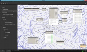

I want to use rhynamo imort to revit
The workflow how can I do ?! CSNM.OpenNURBS.Test5-Nurbs
If I use importinstance.by geometry,the workflow next step how can I do ??

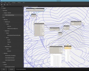

If you want just the linework, all that is left is to connect your NurbsCurves to a “ModelCurve.ByCurve” node. However keep in mind that Revit’s geometry engine is quite picky about the NurbsCurves it can create and some of the lines might fail to cross over.
I agree with Dimitar. I am certain that some of your line-work will not cross over correctly.
How can I cross it ?!
I use ModelCurve.ByCurve can’t connect NurbsCurves
