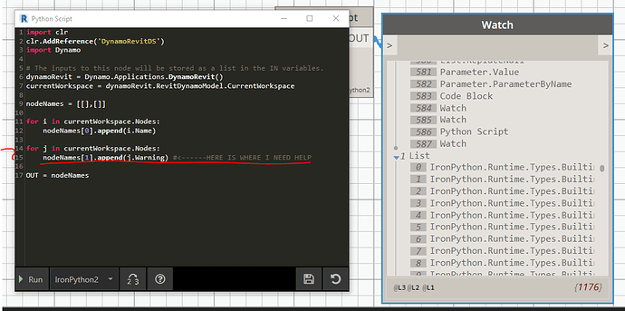

Return Current Dynamo Workspace's Warnings
I was trying to reference this post’s solution and I want to add a little to it. I want to return all of the nodes as they do and then somehow access if the given node is returning a warning. I can then return this as an output to the user in some form later. Trying very hard to find documentation on the Dynamo API…but to no avail.
Thats a great topic!
I look for Dynamo API stuff… i cant realy find. i would like do costumnodes…
# Phython-Standard- und DesignScript-Bibliotheken laden
import sys
clr.AddReference('DynamoRevitDS')
import Dynamo
# Die Eingaben für diesen Block werden in Form einer Liste in den IN-Variablen gespeichert.
dynamoRevit = Dynamo.Applications.DynamoRevit()
currentWorkspace = dynamoRevit.RevitDynamoModel.CurrentWorkspace
nodeNames = [[],[]]
for i in currentWorkspace.Nodes:
	nodeNames[0].append(i.Name)
for j in currentWorkspace.Nodes:
	nodeNames[1].append(j.Warning)
OUT = nodeNames
