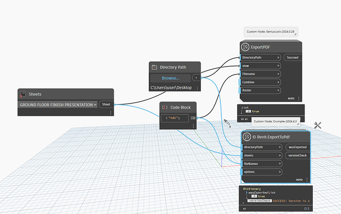

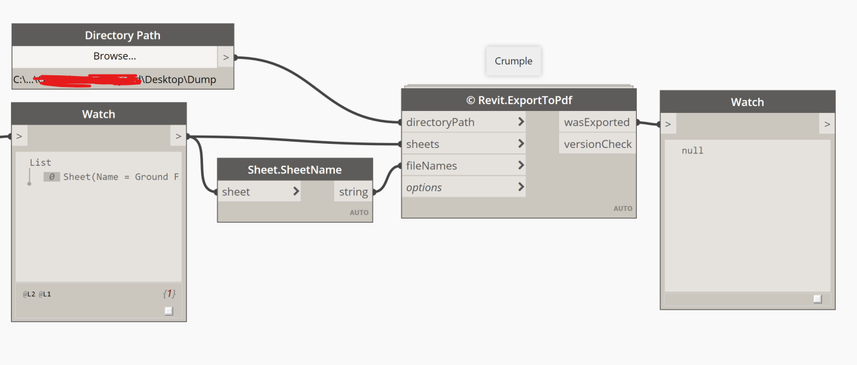

Hi all, given the export limit of the free version of DiRoots ProSheets, I’m making a PDF & DWG exporter (while I try and debate to my management that it’s worth paying for!).
I’ve got examples that work nicely for Revit 24 & 25, however our office has a stubborn project that is still in 22, and I can’t seem to get any Export PDF nodes to behave?
I’ve tried Crumple and Genius Loci.

Whilst I no longer test in Revit 2022, all the necessary API is there and I don’t believe I’m using anything exclusive to 2023+.
Try this file and let me know if it throws an error, it’s using my Python code insitu with no pacakge dependency. Should attempt to export the first 5 sheets it finds:
TryToExport.dyn (15.1 KB)
My Python code for reference (I’ve hard set the options whereas in my package it takes a list of booleans from another node):
