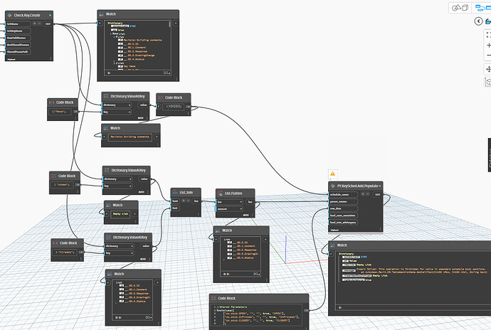

Revision Key Schedule (Building Comments) + AddRevision.KEY values

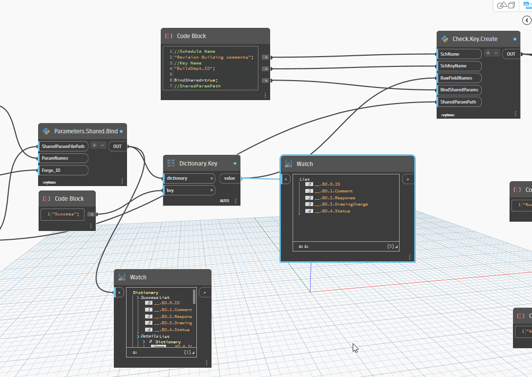

Building comments dynamo- Uses fixed parameters to store building comments and record replies and statuses. I fear there is no ‘legit’ way in the API to fill in place holders. We do have ideate- which can read and write the key schedule but cannot save the key schedule definition :face_with_symbols_on_mouth: which I am chatting with them about now.
The attached DYN
View+Revision-Schedule-Building-Dept-Comments-Create.dyn (69.8 KB)
Uses the dictionary value at key and a slider to select the category to store using Forge_ID. (could be a DYF)
This then binds in the shared params to the Key Schedule.
These get passed to the Check.Key.Create which creates the Key Schedules if it can find the params and associated with revisions (cat = Category.GetCategory(doc, BuiltInCategory.OST_RevisionClouds)
then I wanted to populate some key values in the DYN with the output of the create node and I cannot populate the values.:collision::brick:
Each run creates a new line but reporting it cannot modify the content.
Just need to verify that is indeed the case- if not is there a work around?
Py.KeySched.Add.Populate:
# Dynamo Player-safe Key Schedule row adder with duplicate check and built-in Yes/No handling
# IN[0]=schedule_name (str)                      # exact schedule view name
# IN[1]=param_names (list[str])                  # headers OR field/parameter names; "Key Name" optional
# IN[2]=rows (list[list[Any]])                   # each inner list aligns to param_names order
# IN[3]=case_sensitive (bool, optional)          # default False
# IN[4]=trim_whitespace (bool, optional)         # default True
# OUT: dict with ok, message, scheduleId, isKeySchedule, results, insertedRowIndices
