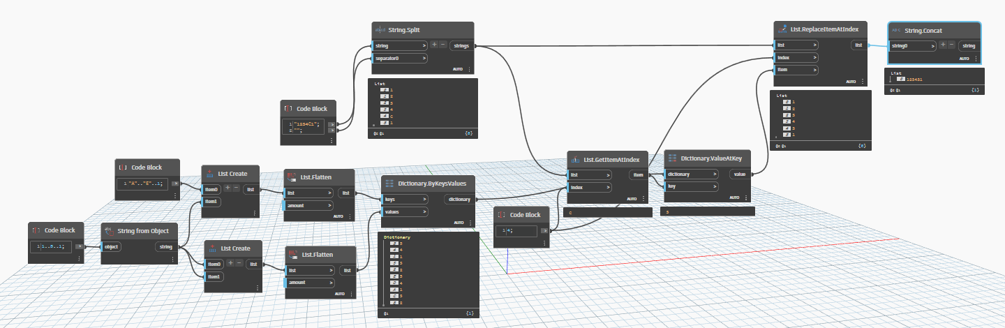

I have made some good progress from yesterday, I have attached an screenshot of my updated script. Thanks for your help so far.
I had to add a String from Object again after String.Length for items to appear in the watch list.
I have managed to use the String.Split node which has split the lists into individual lists.
I now want to break each entry down into its individual characters so I can target the fifth character and replace it with the letter I need. I have had a look online and can’t seem to work this out.

I now want to input all my building number into this instead of the Code Block I have used as an example. I have given this a quick go and my index is looking at the fourth building number not the fourth character of each building number.
I am very early on in my Dynamo learning looking at code is going to blow my mind at this point.
You still have to Split and i guess you entered Levels and Lacing territory ;).

Please see the screenshot attached, I have linked my building numbers directly into the String.Split node and used a blank string for the separator.
I am getting an error when the script reaches Dictionary.ValueAtKey.
My first guess is you miss 0 (zero).
Add that to your Dictionary.

List levels are definitely the next step. Using a dictionary to update the value of the 5th character (4th index) makes that step trivial and then you just replace the old value with the new one and re-join.
I’m not sure this is the issue as the script outputs exactly what I want before I inpute my building number list.
Using the the test Code Block the building number is split into it’s 5 characters and I am able to specify the fourth index and replace it with the relevant letter.
Inputting my building number list the List.GetItemAtIndex node picks out the fourth index which gives me the fifth entry in the list.

I need to somehow break down each building number into a list of then of characters and then find the index.
@Nick_Boyts made a great example of everything I was saying.
Just replicate that and you should be good to go @fintan.sumners.

Why would my building number list created from “Element.GetParamterValueByName” be acting differently to a Code Block with the same numbers.
You need to use List Levels to specify that you want the 4th index of each sublist. Right now you’re just getting the 4th sublist which is the 4th building number. The difference is the list structure you’re providing, not the code block or its values.
