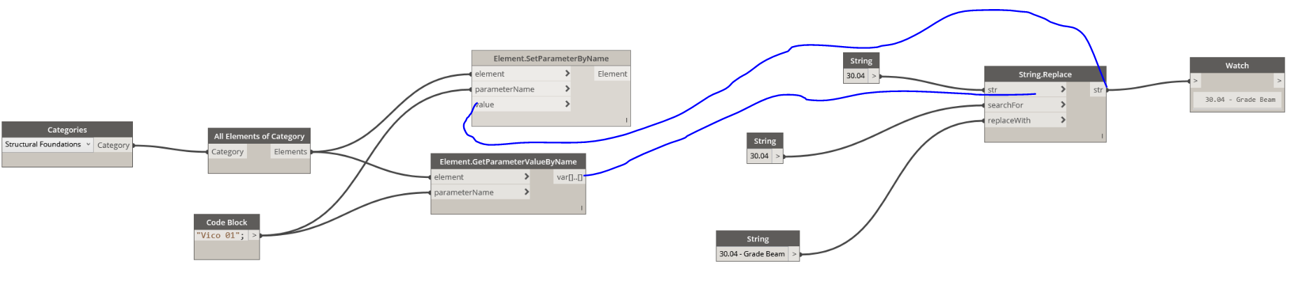

I’m very new to Dynamo and i don’t have any experience in coding, I hope my question is simple!! Thanks for taking the time.
Under properties in Revit I have something called Data (Vico 01) it’s part of the Project Parameters
so what I’m trying to do each time I write the number (30.04) under Data (Vico 01), i want to run Dynamo and automatically change it from (30.04) to (30.04 - Grade Beam), as you can see here i tried do this
but i don’t know how to link it to Revit or even if i have the coding right ?!
Thank you for the help again
You need to use SetParameterByName to push the data to Revit:
It may be best to use an if statement like x == "30.04" ? "30.04 Grade Beam" : x; instead of a String.Replace function, as sequential runs will iterate the result, potentially resulting in something like this:

Well, you haven´t connected all the wires. Something like this will do (but strongly recommend that you look what Jacob has said in the previous post)
It works thank you for the help again

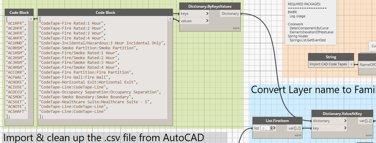

You’re going to want to do some research on Dynamo Dictionaries
A Dynamo Dictionary is basically a table where you can have your number(30.04) in one column and your matching text (Grade Beam) in the second column.
Then you call the dictionary with the code and it returns the text.
Here’s screen shot of one that I made and how it’s used

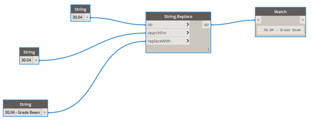

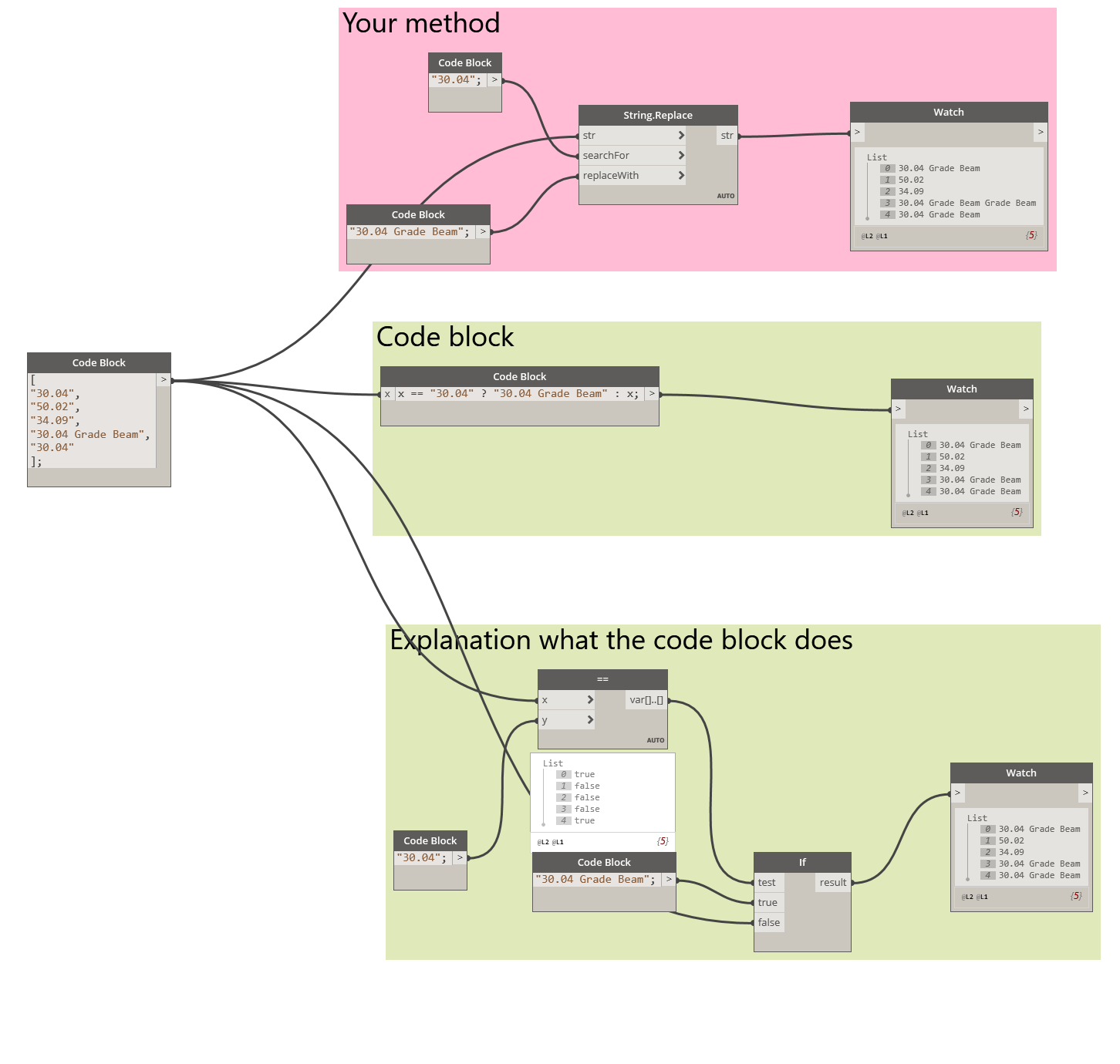

As you can see, String.Replace replaces 30.04 with 30.04 Grade Beam. This can create the names Jacob already mentioned.
If you put the code he wrote into a code block, this no longer happens.
The code block basically tells the following:
  • If the input is equal to “30.04” then output “30.04 Grade Beam”.
  • If it’s not equal then output the original string.
Hope this makes it a bit more clear for you.
