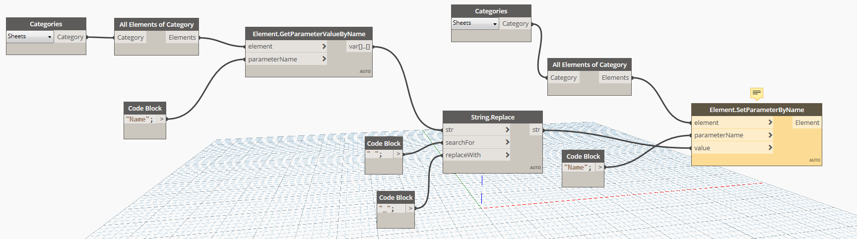

this is the progress i have made so far:
  1. Categories node - Set to sheets
  2. All Elements of Category node
  3. Element.GetParameterValueByName
  4. String.Replace
  5. Element.SetParameterValueByName

The final node, the warning reads:
*Warning: Element.SetParameterByName operation failed. *
No parameter found by that name.
  1. Don’t use a second All Elements Of Category, just string the first one to the last node.
  2. Are you getting Name Values from the node before it. Can you show an image with all previews visible?
Hi @c11431892
The parameter is “Sheet Name” not “Name”.
