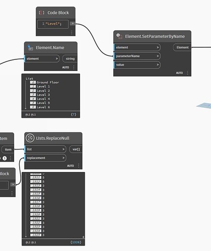

I have a list of index values that represent objects at differing heights. Each object needs to be assigned the text parameter of its level.
Currently, I have a list of levels with index values that correspond to the list of object values. I am struggling to replace the objects value with the text from the list of levels.
Would appreciate some advice to solve this, thanks!

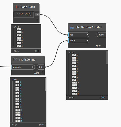

This is something that will get what you are looking for.

Thanks for the Help @bharat.minocha. I will probably be here fairly often now as I try to learn Dynamo so appreciate the warm welcomes!
It works now. Funnily enough I actually had tried that node before but misinterpreted it and connected the lists the wrong way to the node.
