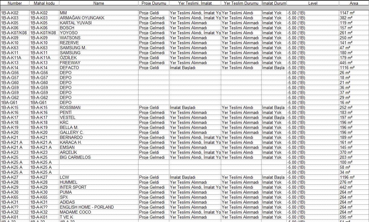

My Revit values are these:
revitdata
Acquired these values through Dyanmo ( Except the first column, its not needed. ) :
revit
And the list of the values that I want to insert to Revit
sqldata
So my aim is to make List #2’s [0] “1B-A-K03” into the value of List #1’s [0] “Mahal-1” and so on.
