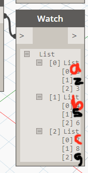

I’m looking for a way to replace items in sublists. List.AddItemToEnd with Longest lacing works fine but I want to replace, not add. List.ReplaceItemAtIndex only seems to work on the top list.

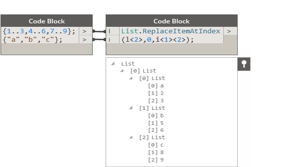

Dimitar, in your example, don’t we want the values of the lower right Watch to show 0,0 = a 0,1 = b 0, 2 = c ?
Think of replacing a column of values in a spreadsheet.

Looking for a result in your sample, Dimitar, like in the image below. a b c should be the 0th place in the sublists. Cheers,

l<2>, not 1<2>
