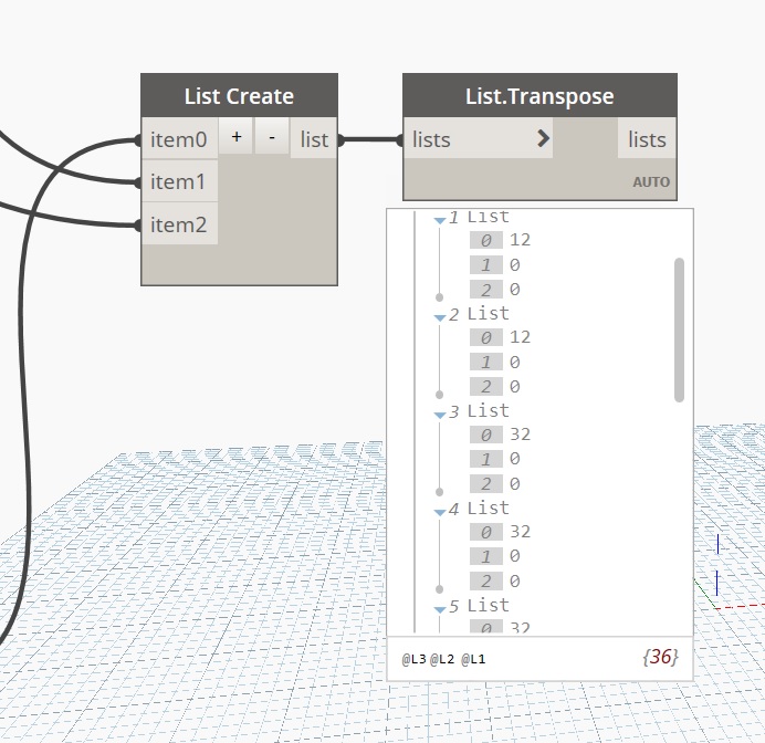

I’m new in Dynamo and i’m trying to do the following in the attached List.
1: Join the lists with the same Indice 0
2: Sum the values from the Indice 1 (with the same Indice 0)
3: Sum the values from the Indice 2 (with the same Indice 0)
List
At the end it should be:
1 List
0 - 12
1 - X
2 - X
2 List
0 - 32
1 - X
2 - X
Please Need a Little help.
Regards

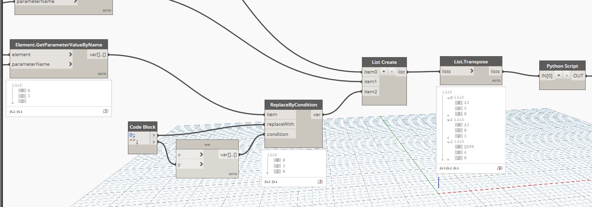

HI

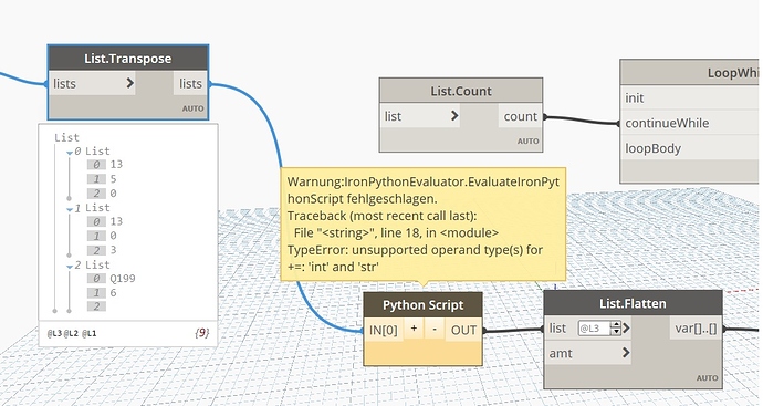

Just realized that i have empty items. How can i replace them with 0
Then the Python fails :sob:
Please help :slight_smile:
Kind regards
OK I have it!
Kind regards
