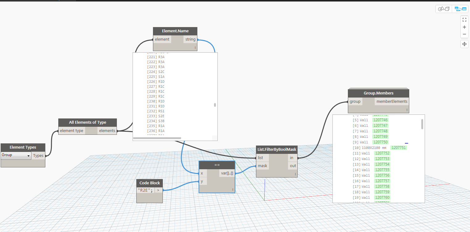

is there is any way to renumber the doors inside the groups using dynamo without ungroup it
There is a custom node “Group.Members” from clock work package use that to collect elements in groups and set parameter.

can i do it without select the group one by one,
because I have a lot of groups and I need to renumber the doors inside these groups , I already create simple dynamo for that but it’s not working unless I ungroup it ,
so if it’s possible to select the all the doors inside the groups without ungroup it or select it one by one
Yes you can. I just showed you an example on how to do.

in the example i need to select the groups one by one yes!!!
my dynamo renumbering the doors using the same room number, so if there is group model I need to ungroup it
or by your way I need to select the groups one by one
my question is when I will run my dynamo all the doors even the doors inside the groups will renumber automatically
You need to first filter groups then rename the doors.
how :slight_smile:

so I’m trying to do the same but can you please explain why we need to use (Equal x to y) !!:confused:
if you see the attachment image shown all the groups that i have, which i need to select all these groups and select ll the doors inside these groups the renumber it
Here are some list of actions in Dynamo http://plevit1.blogspot.ae/2015/01/examples-for-all-list-actions-in-dynamo.html
http://dynamoprimer.com/en/04_The-Building-Blocks-of-Programs/4-3_logic.html
