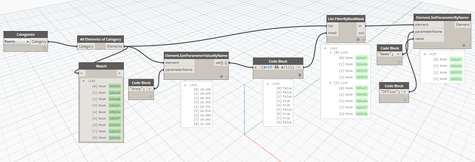

Hey. I’ve got a small problem and I’m fairly new to Dynamo. I want to create a script, that names rooms based on their area. I’ve made a script (see picture below) where I first select the levels, then the rooms and then I sort the “areas” associated with the rooms, so I only display my the area parameters with an area between 10 and 11 m2. But know I don’t know how to convert these areas into elements again in order to use the “SetParameterByName” code block and rename the rooms.
Please help me.
/Christofffer
