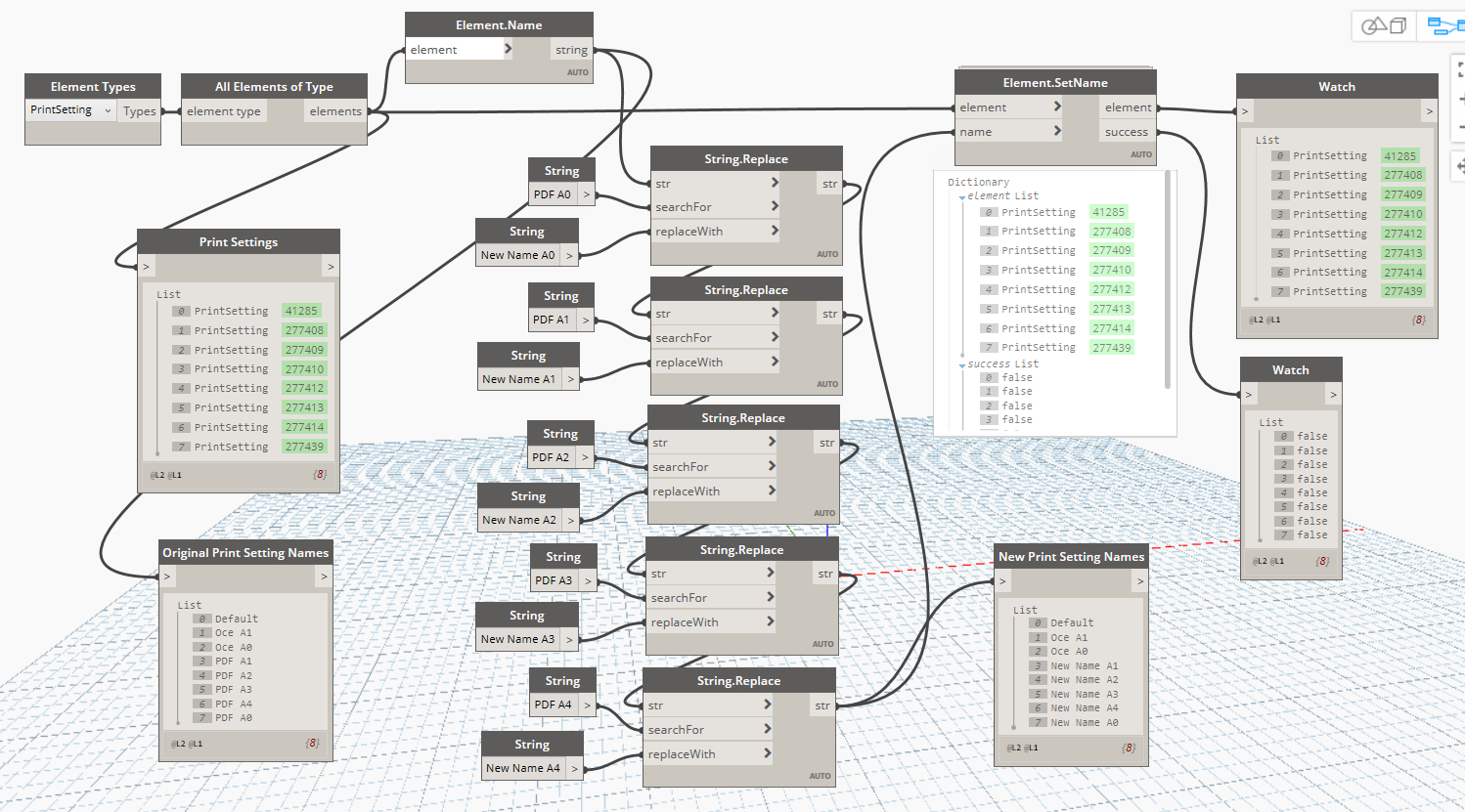

Hi, I am trying to rename print settings with Element.SetName but it isn’t working. I assume the node will take lists of matching lengths (I’ve tried it trying to rename one print setting at a time as well and still no joy) Any ideas what I’m doing wrong? thanks Print Settings Rename.dyn (34.1 KB)

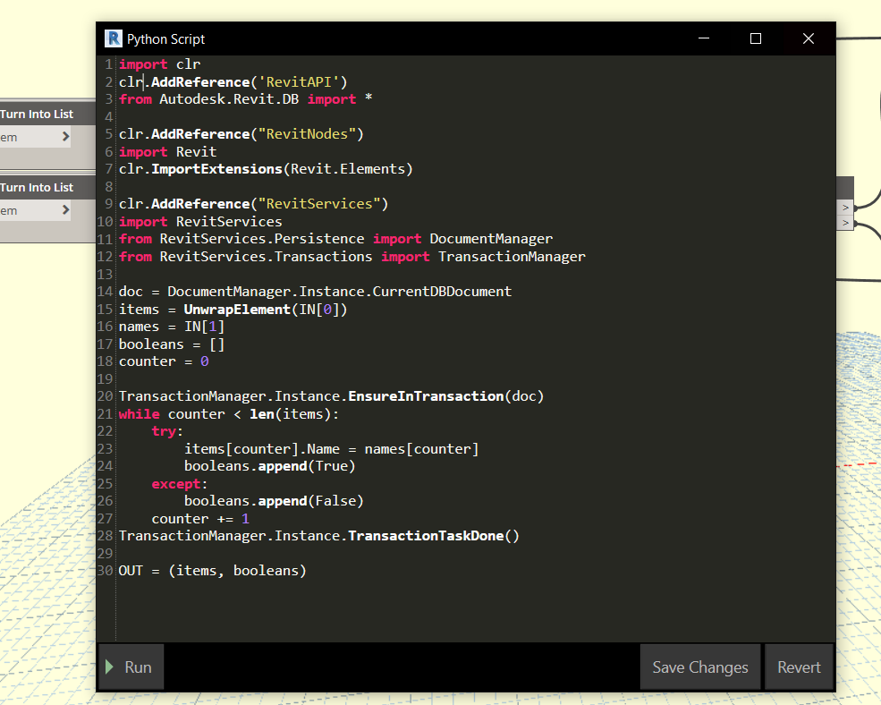

Thank you, do I have to incorporate that into the Element.SetName node or create a new one? - I assume the relevant python script within the node is the one shown below. Also, what is the syntax in Python? sorry, no idea when it comes to programming! Thanks.
I can change the name of the active PrintSetting
clr.AddReference('RevitAPI')
import Autodesk
import RevitServices
newName=IN[0]
printManager = doc.PrintManager
printSetup = printManager.PrintSetup
printSetup.Rename(newName)
OUT = printSetup

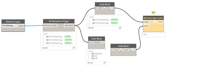

When I try to rename Printsetting Types, I have this error above the Python Script :
Exception: You can NOT set the name here, please set the name via PrintSetup::Rename method!
So I can’t go further.
