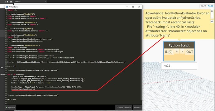

I am trying to learn PYTHON SCRIPT.
My goal is to rename the types of doors I have.
What method should I use to be able to do it? Thank you for your help!
@ammed.riveros try param.Name = “door01”, check this if you want to know more:
That’s what I’m doing…??
@ammed.riveros just write it as I have shown you, and basically, you rename types not instances, so the collector should be WhereElementIsElementType()
You need to use the .Set method of the paramter, not using “=”.
ParaNomTipo.Set(Nombre)

I have followed your instructions… but it is not possible to rename the doors with the new name… why?
ALL_MODEL_TYPE_NAME is a read-only parameter.
While ELEM_TYPE_PARAM accepts writing.
You can use directly the Name property setter
