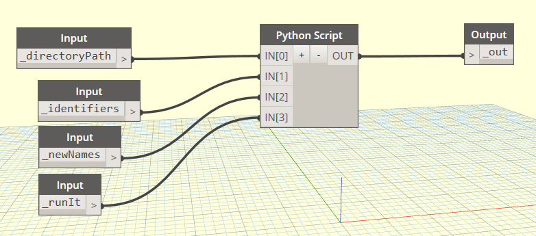

Old topic, but I was struggling with the same problem found by @Vasco_Pereira and I found a solution.
Just delete the default values in the custom node input, make a new custom node and it will do the job correctly.
RenameFiles - solved 1
