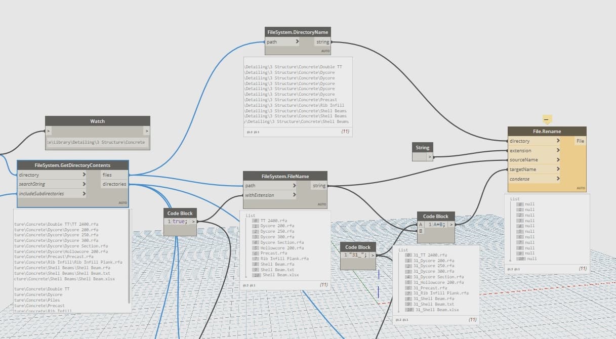

Hi, I’m orchid file rename. Not sure why this isnt working if anyones got any ideas
this renames the first file but not the others
What is the error message?
Warning: File.Rename operation failed.
Could not find file ‘R:\Temp\2021 - CBI update\Library\Detailing\3 Structure\Concrete\Double TT\Dycore 200.rfa’.
Hard to tell, but is the directory input intended to accept a list? Looks like it’s trying to find the second file at the first directory, but all your lost lengths match. Does it work if you just use the first item, or only items from the same directory?
I think you were right with it trying to find the next directory but lacing longest fixed it!
