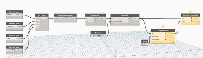

I’m trying to create a Dynamo script that finds all views that contain a certain string and replace that string with something else. Everything works perfect untill the moment I connect it to element.setparameterbyname.
What am I doing wrong?

Try lacing > longest, not crossproduct
What is the warning you are getting
I don’t know what lacing is, but will try to figure it out.
The boolean is not filtering the right thing.
After list.Clean you have Views and then you filter that list again using the 5001 string. This most likely gives you a shortest list.
Use the boolean mask on the List.clean

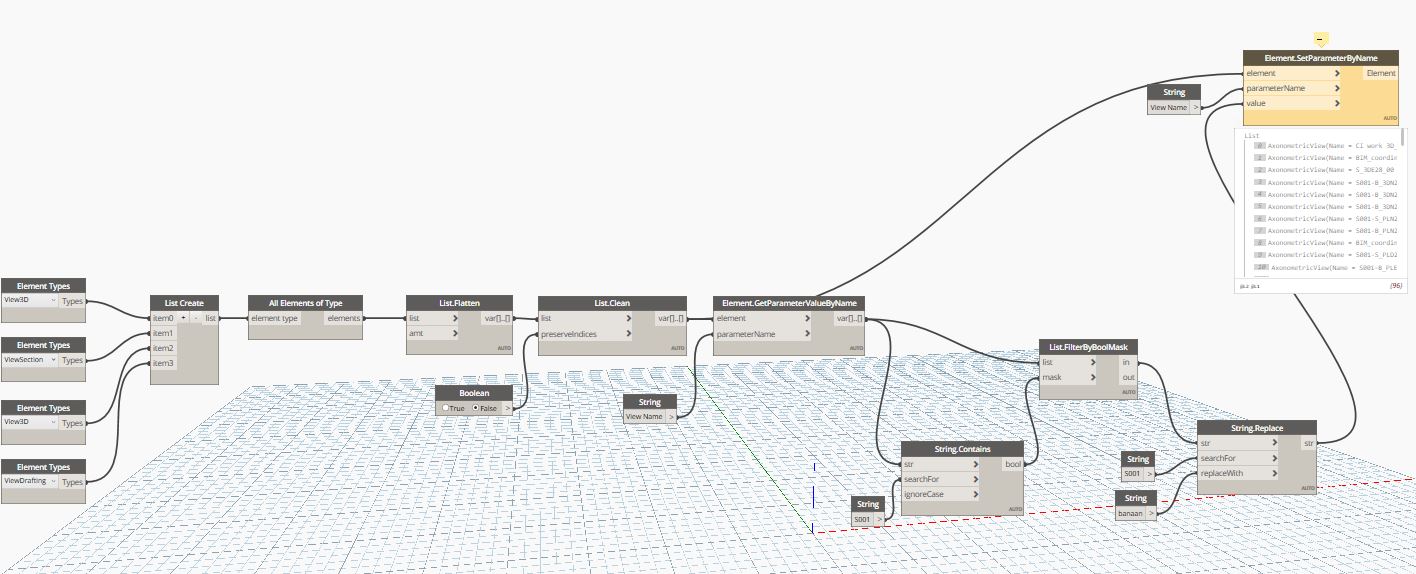

Like this?..thats not working
You still need to get the View Name first. Then you check if it contains 5001 and the boolean result is what you use to filter the sheets

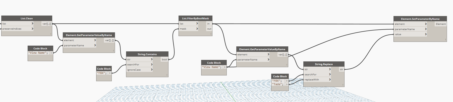

Thank you very much.:handshake: This works …it looks like you can’t replace a string out of a filterbyboolmask list
No the mask is only yes/no and the filter to decide whether you want to continue with the yes or no. After you can do what you want :slight_smile:

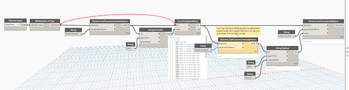

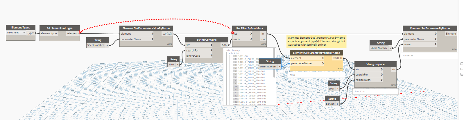

I’m trying to do the exact same thing with sheets, but get an error.
That is because you’re passing element values and not elements :slight_smile:
Sorry that I don’t understand what you’re saying…I’m still pretty much a beginner at this.

What you are doing is finding a “Element” using the Element Types node, these elements are basically containing all information regarding the element.
Using the “GetParameter…” node you are getting a single information from the element, this parameter does not contain any other information than itself.
The filterbyboolmask works by taking all “true” masks and outputting the corresponding list items in “in” and all “false” masks and output the corresponding list items as “out”.
By using the parameter “Sheet Number” for creating your mask you need to actually filter your elements and not your parameters. Thus the red line connecting your “list” of elements filtered by your “mask” of parameters.
