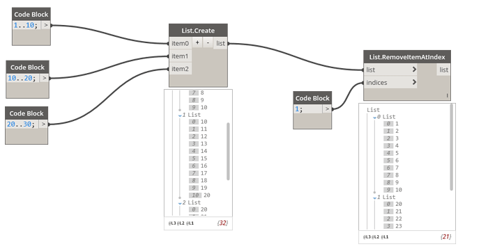

You can simply use the List.RemoveItemAtIndex node.
but with this function i should know the index of the sublist which i want to deleate
It’s right ?
yes
Yes. On what basis do you want to delete it? What you’ll most likely end up doing is finding the index of the part you want to delete and then remove that part based on the index.
Look here, you only need the index of the sublist:

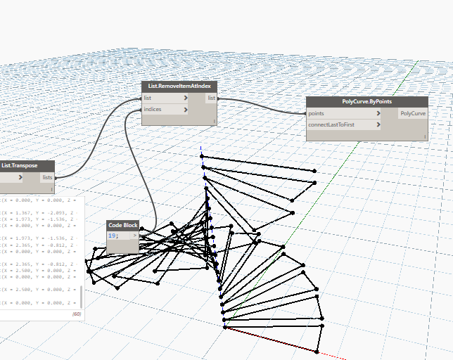

I should create helicoidal staircase which it composes from a list of list of cartesien coordinates.
but it felt a ligne of coordinates for the last step for this staircase…

I want to deleate the last list 19 in order to deleate the unfinished step of staircase.
please show a bigger picture i want to now a little bit more about the inputs
type in youre code block -1; instead of 19
i have tried with -1 in code block.
but it is not possible
i think also you need to use list levelbut i need to now more about the output of List Transpose
Try in the List.RemoveItemAtIndex
list @L3

what is the outcome off the list.removeitematindex?
is 19 still in it?
those 2 points are elsewhere in the list
Do you create elsewhere in the graph a line?
