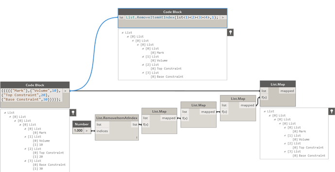

Hi
If I want to remove items from the second position in every sub list, can this be achieved. I’ve tried all sorts.
Thank you,

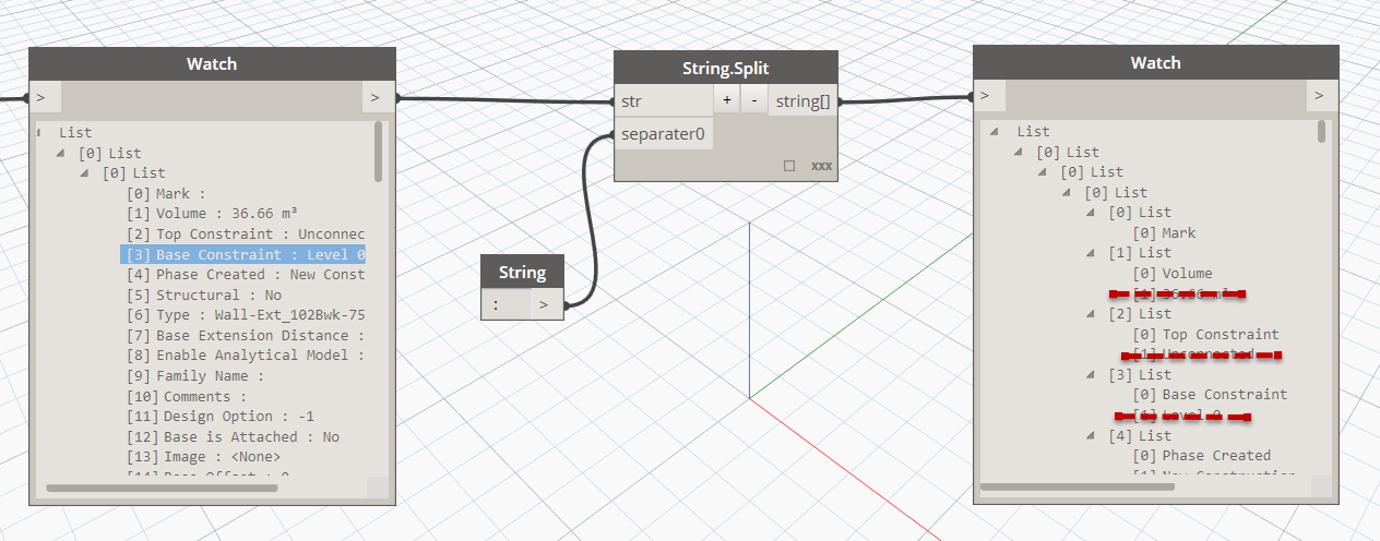

from your list, you need to wire to a “String.Contain”, where you select the " " that needs removed.
then wire that into “ListAllIndicesOf” node.
finally wire that into “List.GetItemsAtIndex”
If you still have trouble, I can post a screen capture later on.
