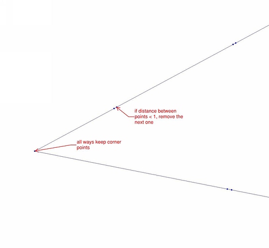

I sort the points alone curve (a close loop rectangular)
I would like to remove some points if they are very close.
for example:
if point A DistanceTo point B is less than 1, remove point B and keep point A
if point B is a corner point remove point A and keep point B
Is a way to done this by dynamo nodes? suggestions. Thanks

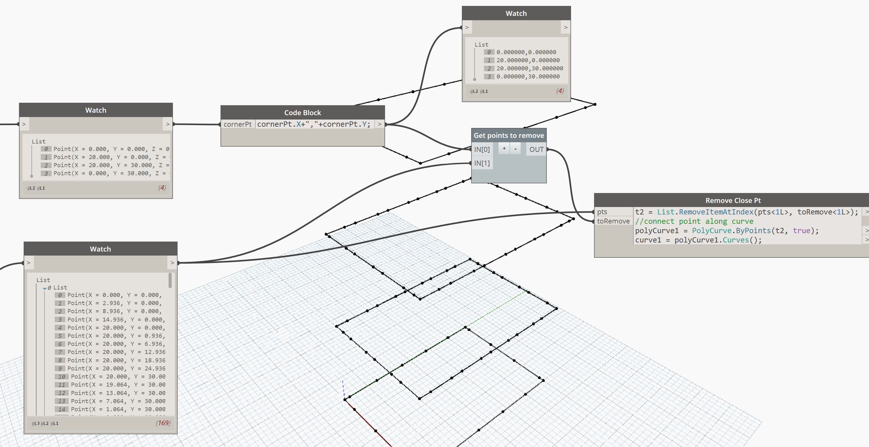

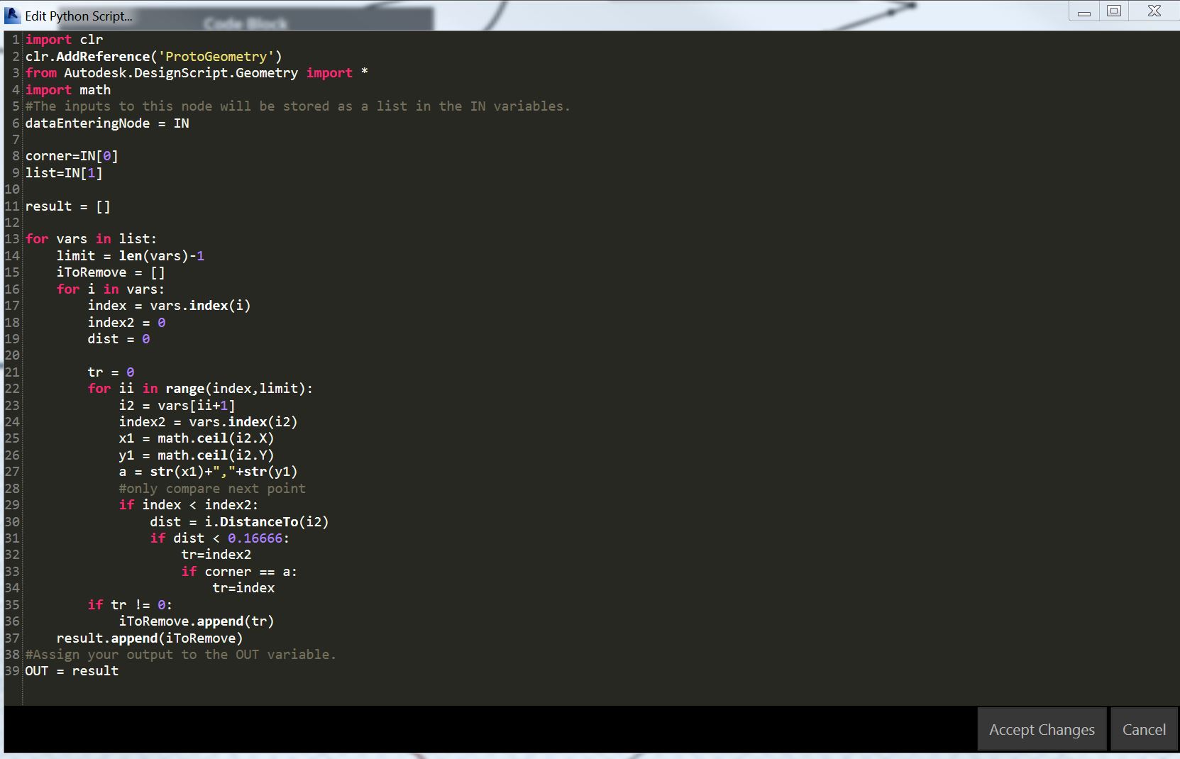

I have it work this time with python scrip,but I think there should be a better way. I’m also new to python. any suggestions to my code would be appreciate. Thanks

But how can I ensure the points right at the corner/a specific point is not being remove?
If there are certain points you need to make sure come through, I would recommend getting them before you prune your points and just adding them back to the list afterwards. This is really easy with corners because you can just grab the start/end points of the line.

yes, I add all corner points back after pruneDuplicates and remove points close to the corner by script. this trick works.
