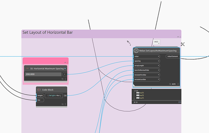

Rebar.SetlayoutAsMaximumSpacing doesn't work on revit 22~25
Hi everyone!
I’m using package Dynamo for Rebar on RV22~25. But “Rebar.SetlayoutAsMaximumSpacing” node has no results.
Note: This node working fine on RV20~21.
Any help would be appreciated, thanks.

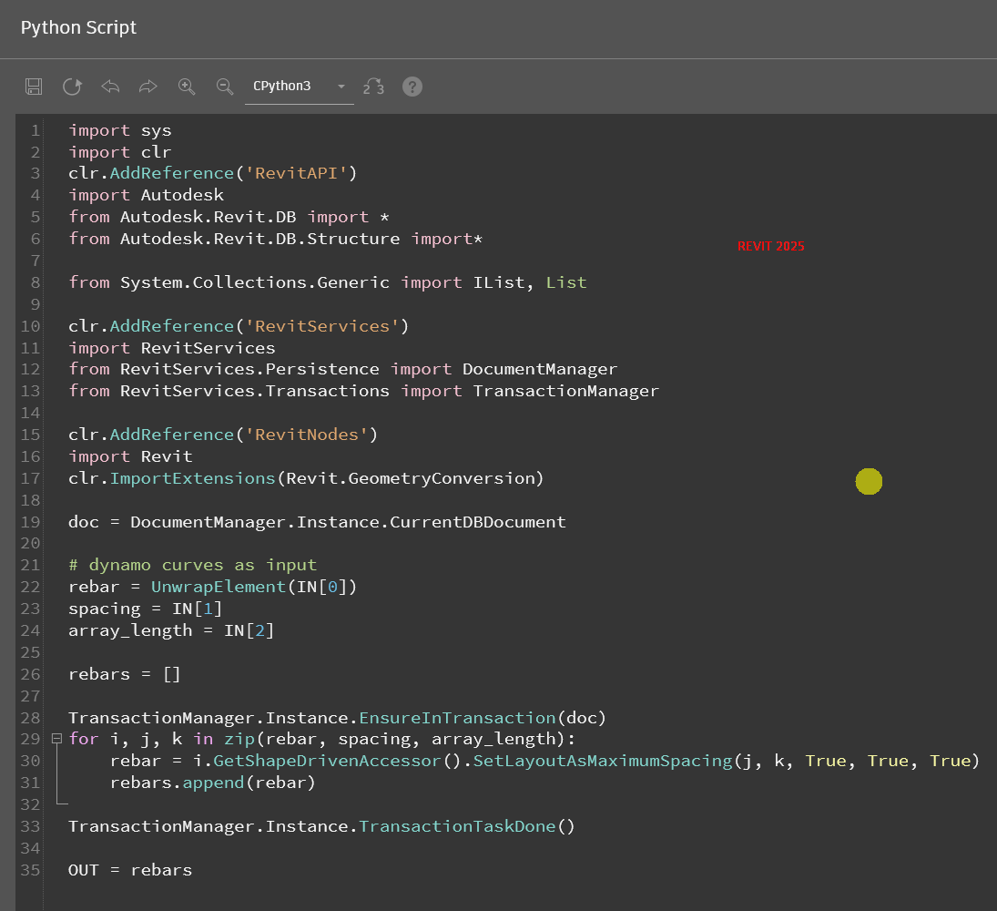

seem the package is outdated
Try doing this in Python or another package.
or
Hi friend, if they work from 2020 to 2025 (it may not work for you because of the units, update Python 3 or maybe it’s the polycurve), I work with the structural design package. For Revit 2026, it doesn’t work because the author is pending an update.
DYNAMO REBAR:
Hola amigo si funcionan desde 2020 hasta 2025, (puede ser q no te funciones por las unidades, actualiza python3 o quizás es la polycurva) trabajo con el paquete de structural desing, para revit 2026 si no funciona porque está pendiente la actualización por parte del autor.
DYNAMO REBAR: https://www.youtube.com/watch?v=hZ6Xd24MYsY&list=PLnLXyPBhtlYZFae-89aEM1Sgaf0hO8bSO&index=1&t=63s
