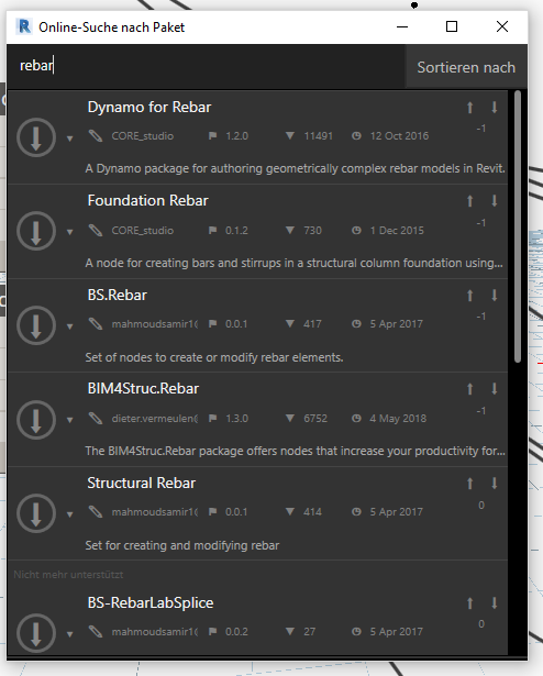

search for packages with rebar and dl one or more

first of all I can’t find rebar oject inside my Library (I tried to search for packages but the reseach is always empty …I think it could be the firewall, working in a company), so I decided to start selecting a bar that I had already drawn in revit, but then it seems like I can’t get any property out of it.

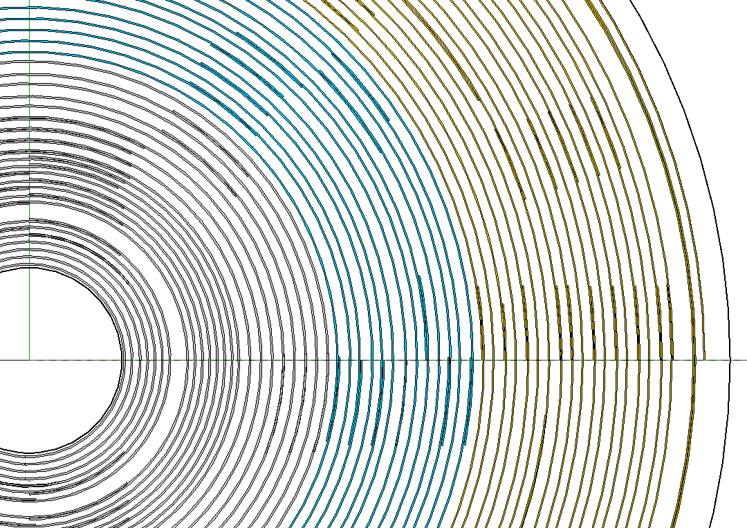

Basically what I need to do is to find a way to manage curved bars (lenght, section dimension, circular distrubution) to apply a concentric offset having the possibbility to set different properties for each concentric circle.
You can also download packages with https://dynamopackages.com/
