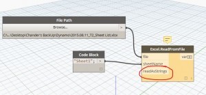

Hi Guys,
Could anyone highlight the meaning of ‘readAsStrings’ ?

It will pull all of the data from the excel file as strings (Text-ish). Even if they are numbers (integers). This means we can tie that to text parameters in revit right away or insert other strings. It takes a Boolean to toggle it
I hope that makes sense.
And just to provide a little more info. A string is defined as a sequence of characters.
Thanks for the prompt response, John !

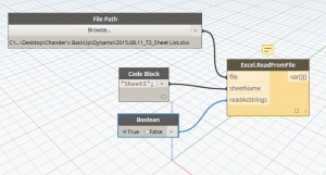

Pls see attached. Why am i getting an error in reading a simple excel file?
Regards.
Add a file from path node between file path and excel read. That should do the trick.
Beautiful.
Thanks so much, John !
