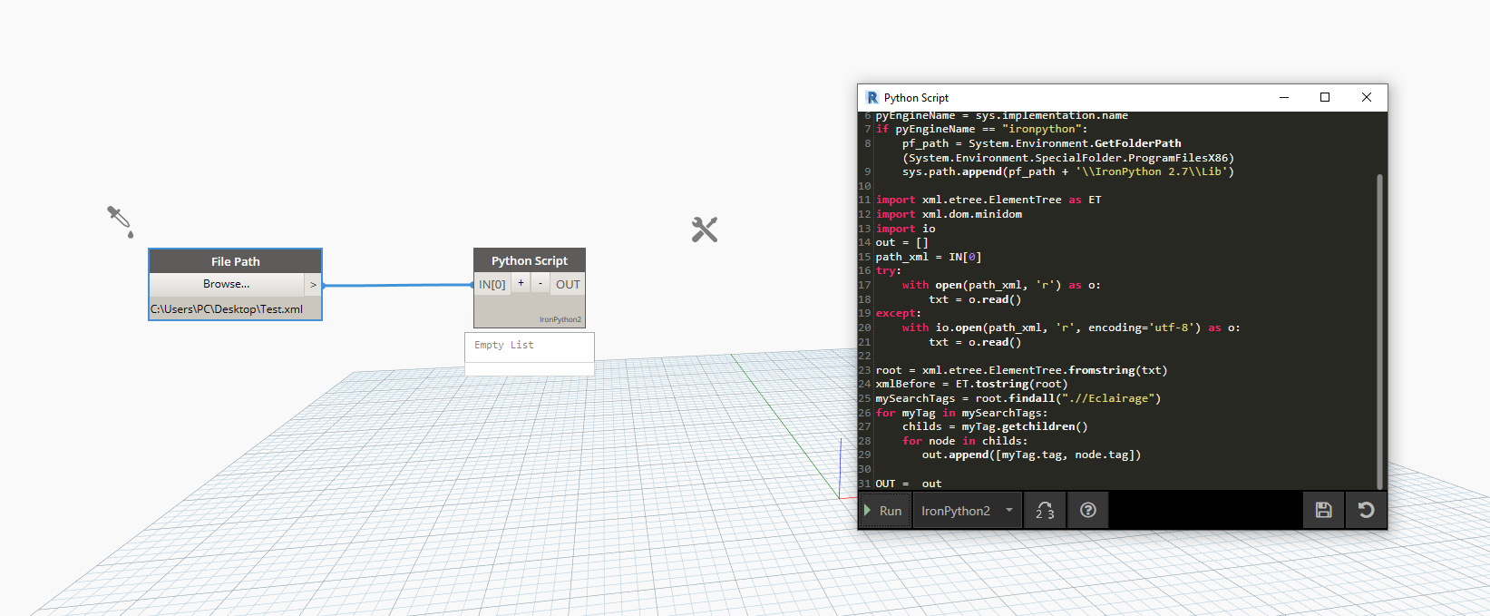

@c.poupin Hi, I try using your code but it returns me an empty list. Do you know why?
Hi @Luffy11 ,
probably you haven’t element node named “Eclairage” in your XML file, you need to adapt the code

@c.poupin Thank you for replying me but I don’t know code. Is there any node in Dynamo with similar function?
Before there was the LunchBox package, but the development was stopped, now I don’t know
@c.poupin yeah, I’ve installed LunchBox package but can’t find the nodes relating to XML. Let me find another way. Thank you for your reply.
