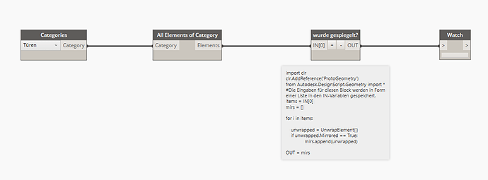

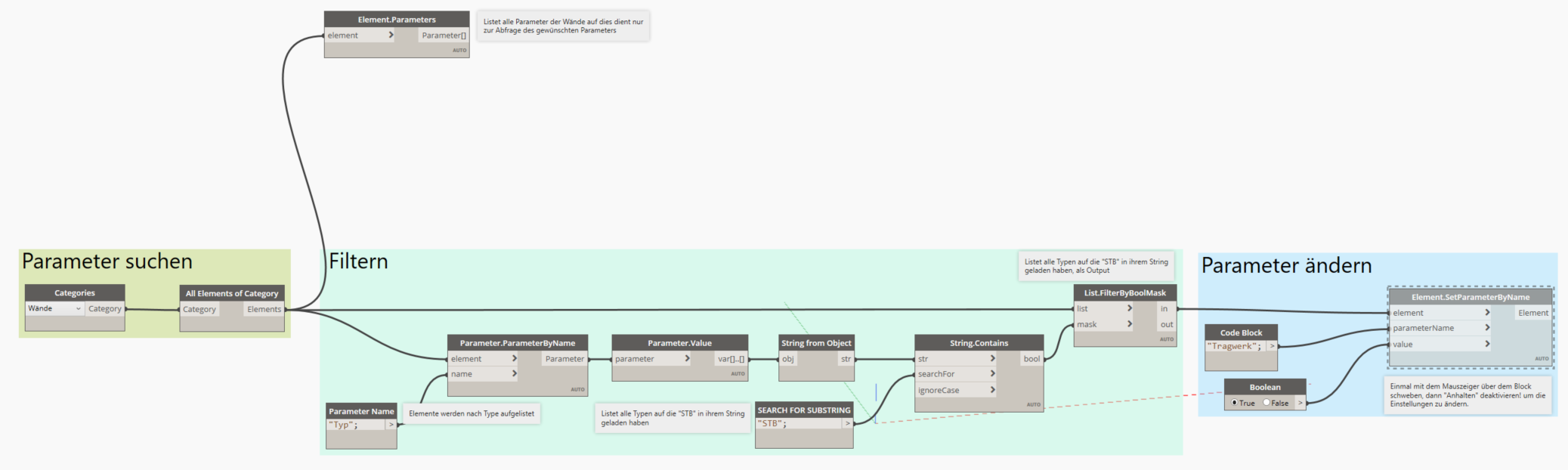

here some examples of my qualitycheck:
1.) Regulary dynamo
2.) deep Dynamo with Python
Does anybody have other ideas to get information out of my datamodel
…with python
