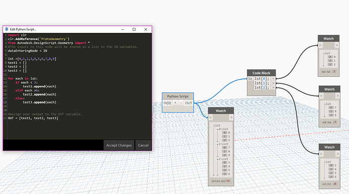

From python you will get one output. The easiest way to solve your problem is to organize your filter in lists and Output them as a list.
With this method you will have a list with three lists as an output. Then you just need to add another code block node that takes each list, like this:
lst[0];
lst[1];
lst[2];
(If you have 3 main filters).
If this works, and if you know you’ll need this process very often, you can also create a simple custom node with all the outputs needed.
Tell me if I’ve been clear!
Andrea

It’s very easy actually, but I didn’t understand your syntax. Try to use a cleaner code, your indentation was incorrect. Hope is clearer now, if not, give us your input list and I’ll write a filter for you, but try by yourself first!

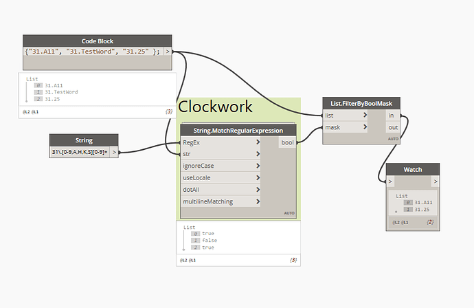

Hello @3Pinter! Maybe a regular expression would be easier in your case?
Here is a possible pattern:
31\.[0-9,A,H,K,S][0-9]+
Yes, in this case is far better! I assumed @3Pinter was trying to learn python, we already have lot of packages for filtering. Great node, by the way, Clockwork is always very smooth!
@andrea.nicosiavinci I am! Understanding how things work, makes creating things through nodes / own scripts a lot easier.
@Einar_Raknes interesting, I will check that one. Was fiddling on https://regex101.com/ for that one :slight_smile:
