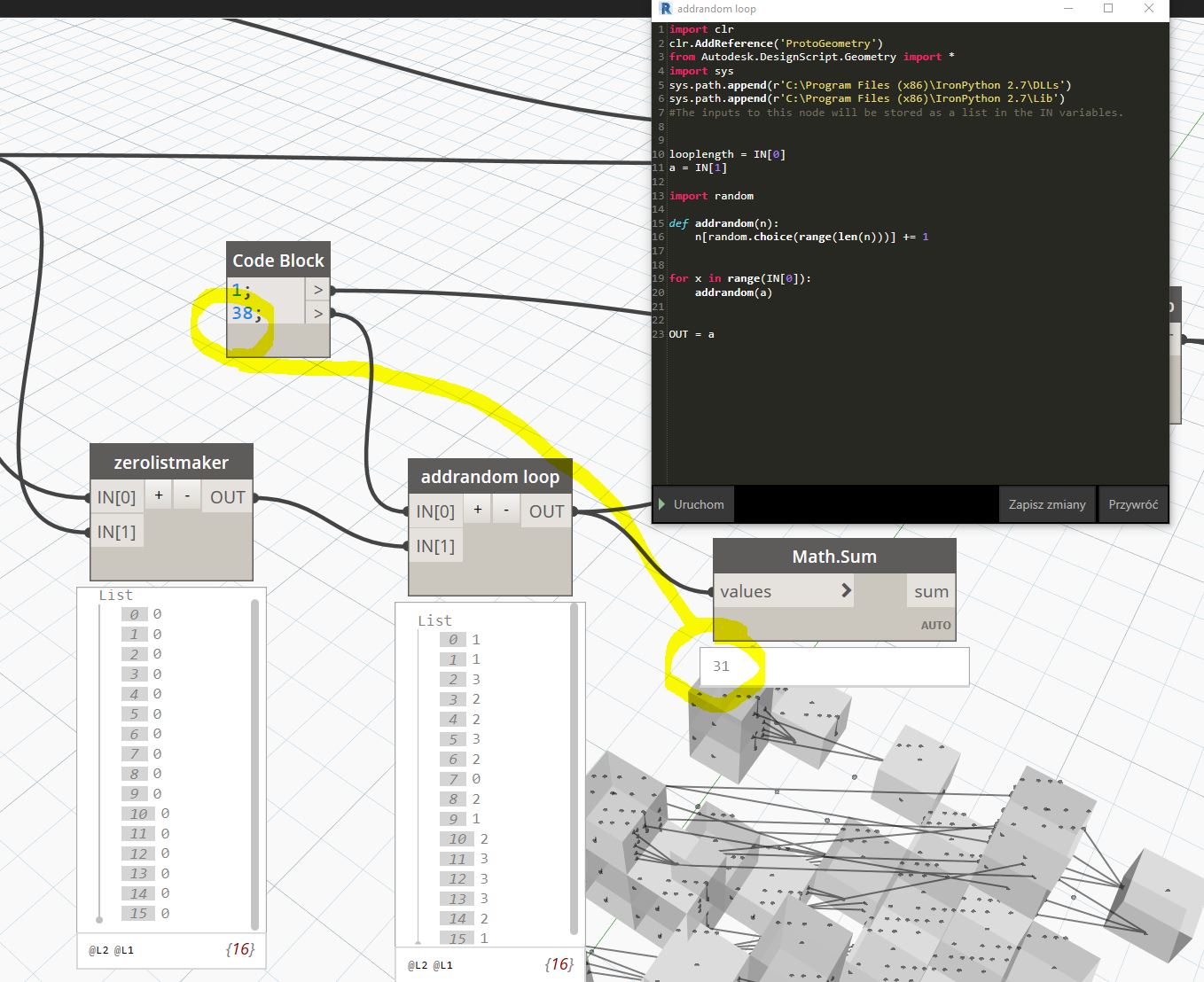

Hi all, I stuck on a problem while trying to optimize my dynamo script. This simple method should with every loop add number to random item in a list, but after the process i got sum bigger or smaller than I did loops and adding +1. Here is my code and printscreen. In python idle everything working correct.

looplength = IN[0]
a = IN[1]
import random
def addrandom(n):
	n[random.choice(range(len(n)))] += 1
for x in range(IN[0]):
	addrandom(a)
OUT = a
EDIT: Python idle was 3.7 Dynamo 2.0 Revit 2019. Looked if random.choice was different in 2.7 but everything seems the same. Looks like a sort of bug for me

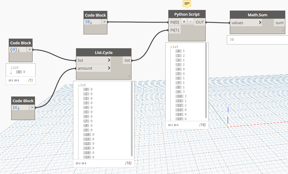

@2shy It’s working for me
EDIT: Actually it’s not. it gives another sum if disconnect and reconnect the code block with the number 38
Python idle is 3.7 and dynamo is 2.0 Revit 2019, is it any significance?
ironPython is 2.7 in Dynamo - so maybe :slight_smile:
@2shy I don’t know why but if you change your function as shown below it works.
def addrandom(n):
	randomInd = random.choice(range(len(n)))
	n[randomInd] += 1
Well thats a mystery, big thanks.
