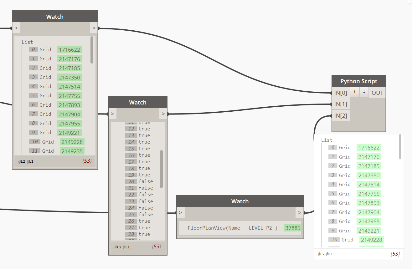

I am new to python and trying to wrap my head around writing an IF statement with a Boolean list input. Can I just call if bool: or do I need to call the items in the index if i in bool:? is this even close?

I am trying to turn the grid bubbles on at the top and right sides and off for the bottom left. The true and false are checking if the End0 is on the top right (true) or bottom left (false).
So for grids that have End0 in the top right there is a true Boolean in the bool list. It should turn on the grid bubble at End0 and turn off the bubble at End1. If the grid was drawn in the other direction it will turn on the bubble at End1 and off at End0.
