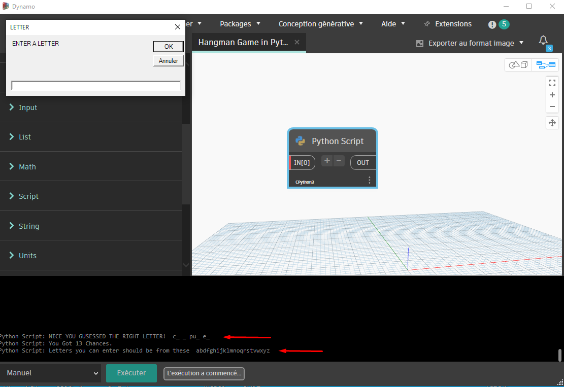

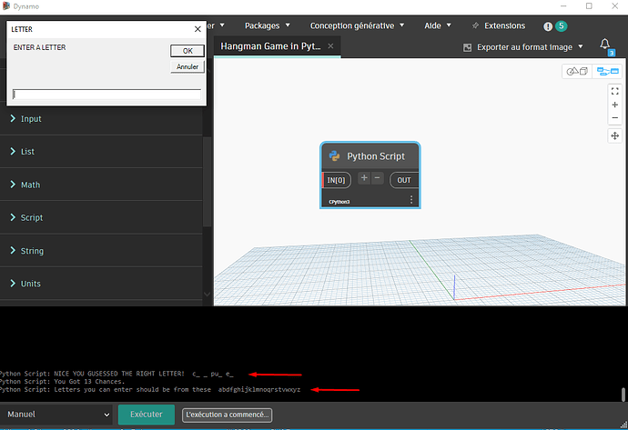

Dynamo is not a console application, “input” do not work
try this version

            guess=Microsoft.VisualBasic.Interaction.InputBox("ENTER A LETTER", "LETTER", "", 0, 0)

Thanks a lot for your time and kind response. I am going to try this solution.
