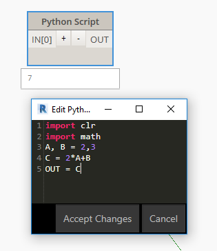

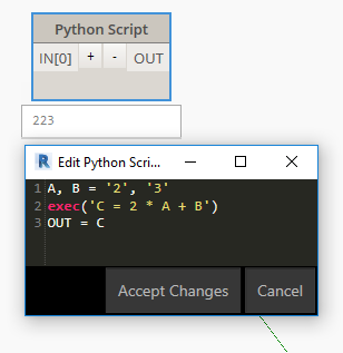

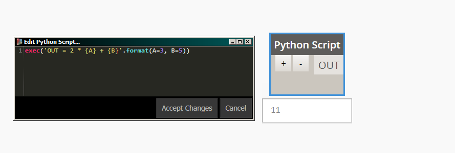

Posting the error and the code would definitely help. Exec should work fine inside of Dynamo:

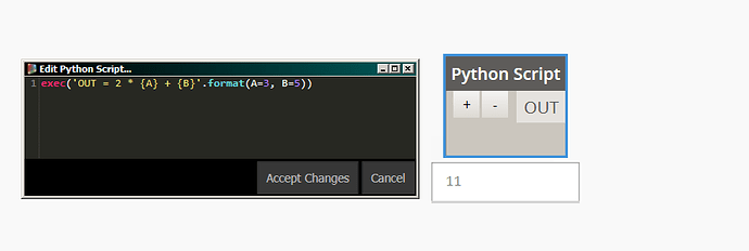

You’re possibly trying to reference an argument before assigning it. Maybe having keyword arguments would be easier in that case?
But using strings will give wrong results, at least that’s was what I meant in my original reply :wink:
Alternatively you can import the “math” module in Python

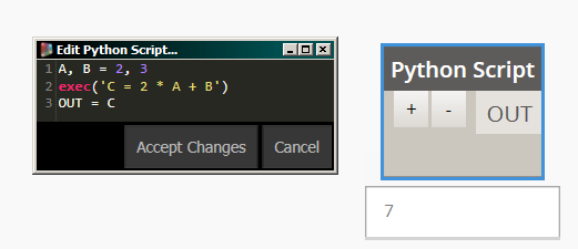

dimitar thank you for your reply.
just found out that it is a problem with dynamo 2+
going back to 1.3 everything is working.
btw code is just the same as your smple :wink:

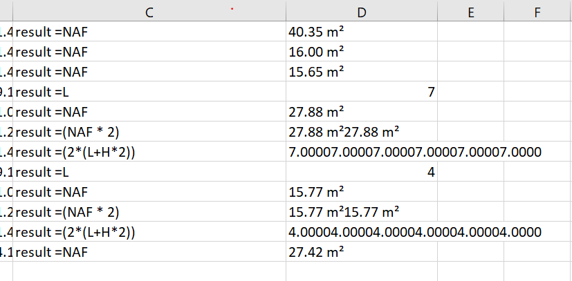

weird thing it that dynamo doe not calculate but writes output multiple times
It seems that it is repeated the number of times that your formula states?
E.g. “NAF*2” is repeated twice…

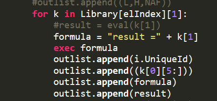

Can you show your entire script and possibly the input from Dynamo if you have that? It would make it easier to understand… :slight_smile:
Exactly that is the Point ?!

If any of your input arguments are strings and you want to use math on them, you’ll first have to convert them to a numeric object. For example:
A = float(“1.23”)
B = float(“4.56”)

thought that even variables shall be string.
by converting them to numbers solved the problem
