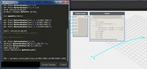

I explain the problem better:

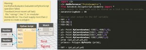

in the first figure the error is at line 17 (input = 2:02)

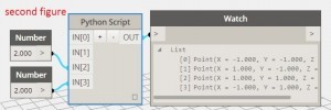

in the second picture I delete the row 17 -> works —> Press 4 points

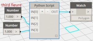

in the third figure remit line 17 (input = 1 and 1) -> works —> Press Polygon

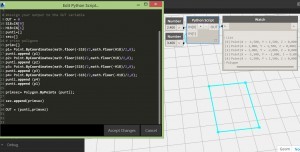

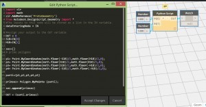

I changed the points and work … but … if I use the phrase:
points = {p1, p2, p3, p4, p1} —> is error (see picture)
if you use the list ----> works (see picture)
what is wrong ??
Thanks again for your cooperation
alex, i didn’t test but i think “polygon” is always closed. so the second p1 is a duplicate point the result = a segement of length 0 (from p1 to p1)
