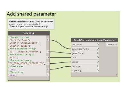

is it possible to similarly to Family document add share parameter from the Orchid Package
Capture
do it with projects?
I cannot find any possible workflow…

I need to feed the project file document, those only work with the active document.
is this possible?
So you want to add one or more shared parameters to multiple project documents?
Yes, you just need to get the document. There are several ways to do that if they are links, or paths, or families. Search a bit and you’ll find what your looking for.
