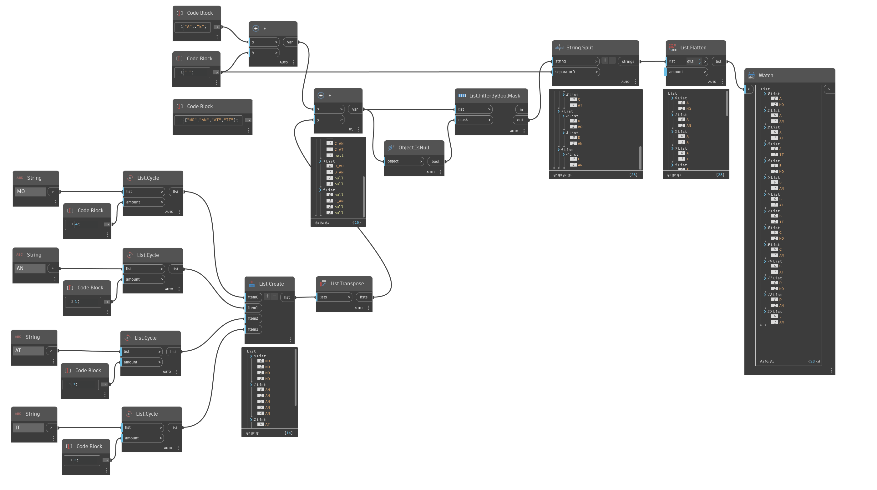

Just listing a simple workflow here I feel would work.
or a more detailed according to the list provided.
