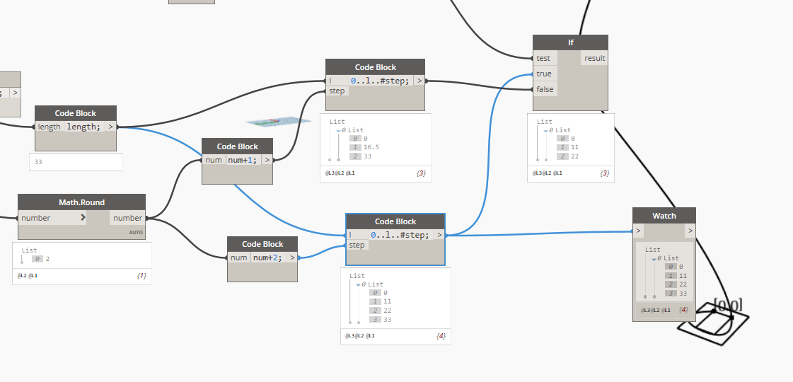

Hey, I am trying to rund a script that will set amount of steps based on an “if” condition in which if true, it should give an output of a list comprised of 4 items, if “false” it should give an output of a list comprised of 3 items (you can see in script).
It seems that when the condition results as “true” and should put list of four items - it only prints the first 3 items, as though the list of 3 items limits the index amount.
I’m am trying to bypass issue but not quite there yet.
Anyone have any ideas?
Hi @zvith !
Here is a way to solve it :
When I have a list with a different number of items I create a very simple Python script. Something like:
result=[]
if IN[0]==True:
   result.append(IN[1])
else:
   result.append(IN[2])
OUT=result
You could also create a very simple If statement through code block:
If == true ? In1 : In2 ;
