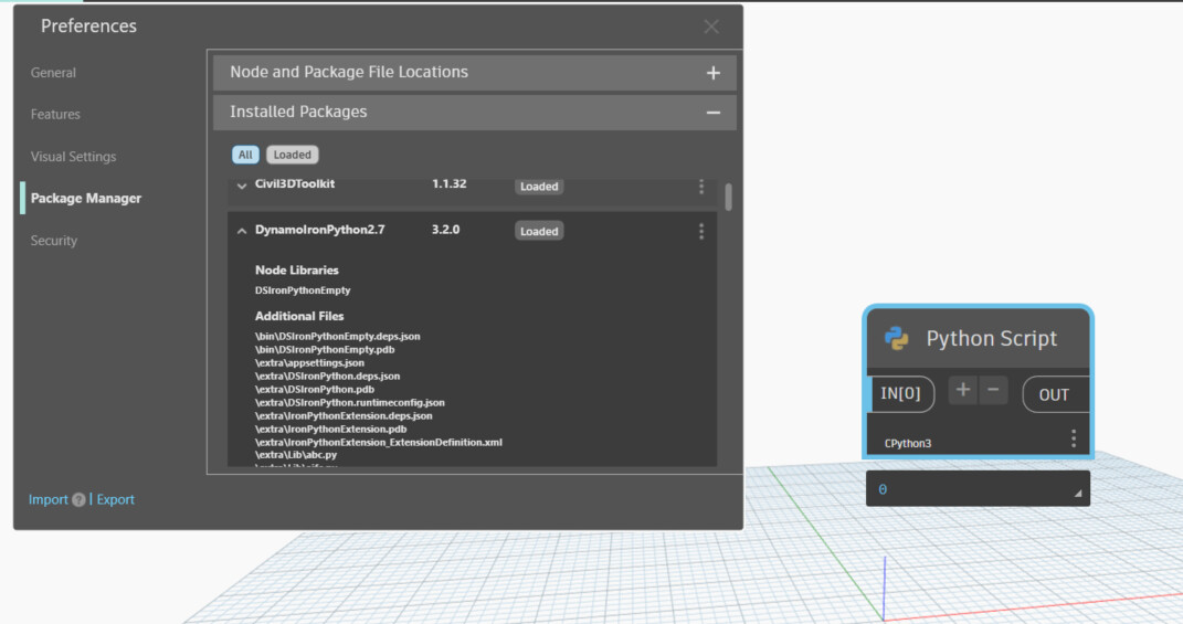

I need to get IronPython 2.7 to work in dynamo again see the reasons from this thread:

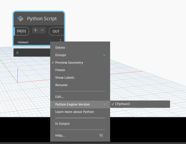

I installed the package but it is not showing up when I try and change the Python Engine Version of a python node:

Hi @cjm,
The version of the package that you downloaded is meant for Dynamo 3.0+, which is built on .NET 8. That’s why this message shows when you download the package in Civil 3D 2024:
If you download version 2.5.0, then it should work correctly.
