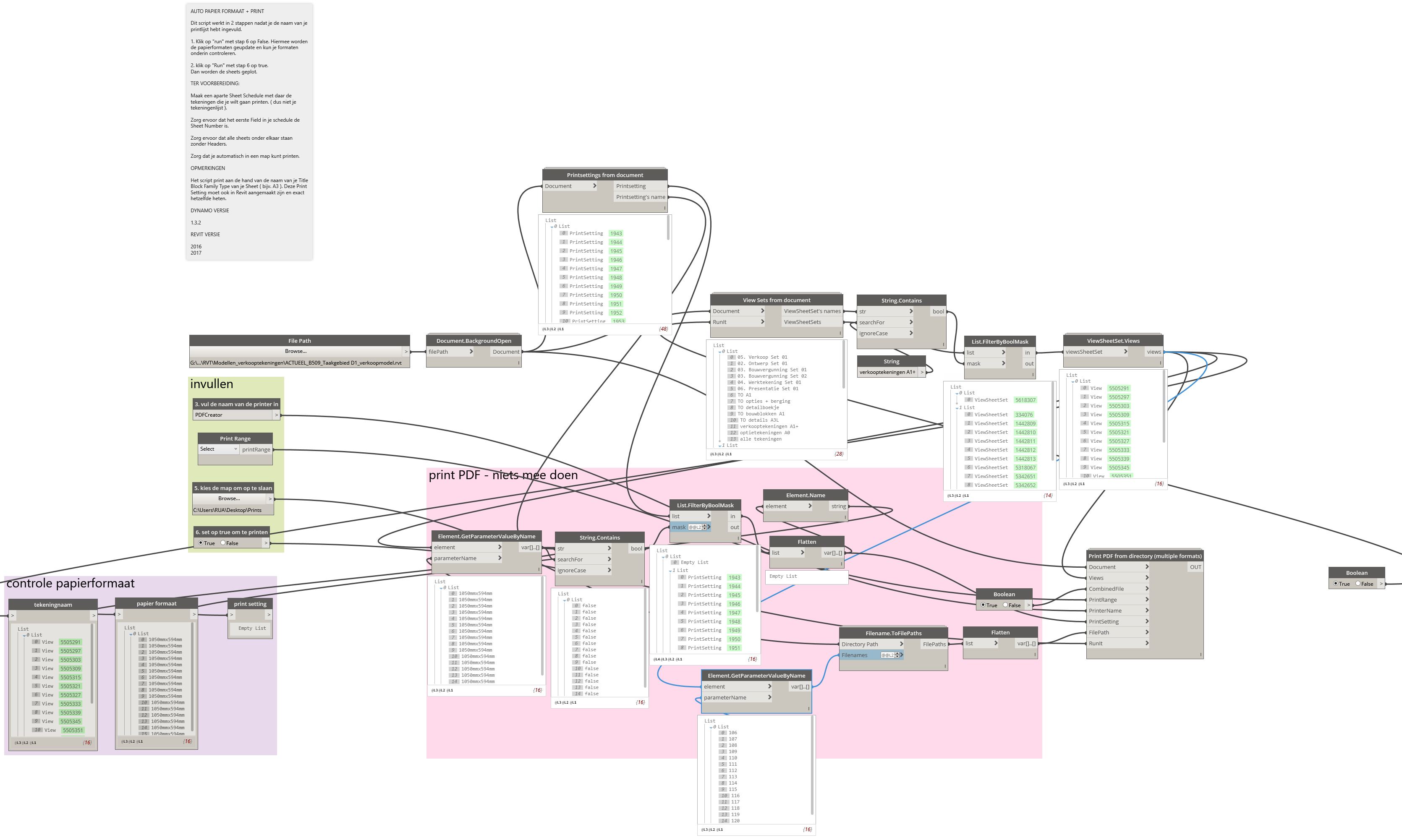

I’m trying to print PDF files in the background with the node from GeniusLoci.
Everything is working fine untill the point I need to compare Printsettings to get the right paper size.
The way I do it now works perfectly fine with Print PDF node that is used in the open document itself. So why doesn’t it work in this script.
Any help?
Thanks in advance!
#21 is the Printsetting from the document btw…sorry for the mess…
This probably has to do with the list levels (sublists).
Can you expand all the previews ?
Like this?
You only have a list of false under String.contains so your List.FilterByBoolMask is empty.
Add some Flatten nodes to only have lists and not list of lists. (After ViewSheetSet.Views node)
I don’t understand how that would help me since the only I do before use List.Contains is ask for the paper size parameter. And I use the information from View settings from document node. And both are not list of lists…
got it!
thank you!
