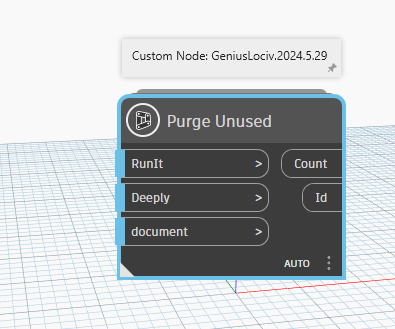

For the purge loop, use this node.

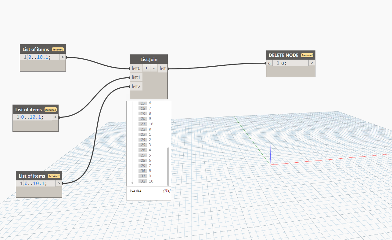

For other things you could join all the lists that go into “element.delete” node and go into one “element.delete” node, then you need a wait node prior to purging unused so it only runs once the “element.delete” node has completed.
If you dont do this the purge unused could run prior to the “element.delete” node and will leave things within the model.
Just because you placed the node to the far right doesnt mean it will run last!!
Many thanks both, I will try these solutions.
I did try just having one delete node but it was only letting me plug in one input at a time.
You do the following to join all the lists together prior to putting into delete node.
