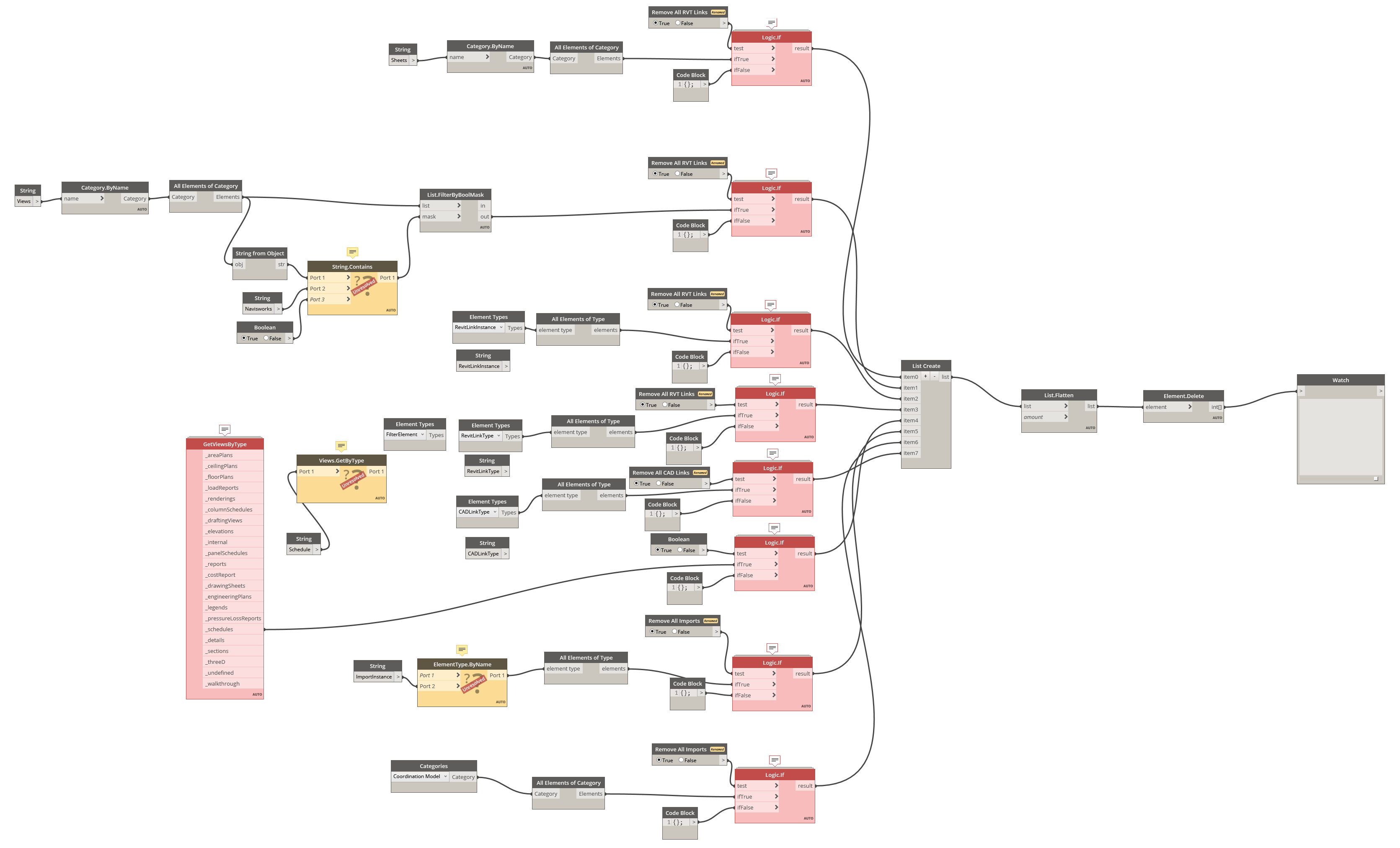

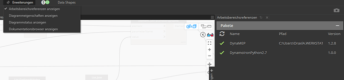

Hi, Can anyone tell me where i can find the missing nodes in the attached image please?
I need them so that I can purge models, links etc from my Revit model,.
Kind Regards

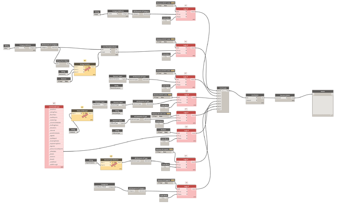

Here you can check your missing stuff
Use archilab package to obtain views by type.
There is an OOTB string.Contains node and ElementType.ByName can be replaced by Element Types.
Replace Logic.If by the OOTB If node or the Scope.If of Clockwork.

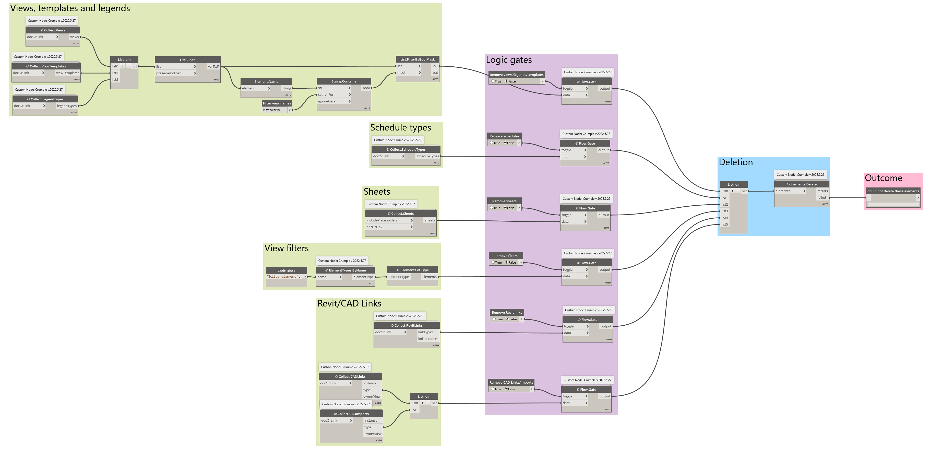

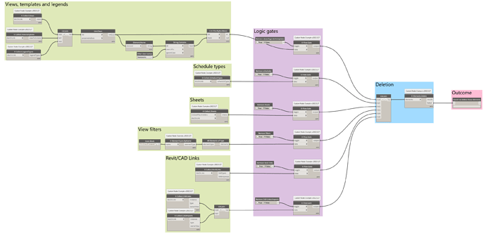

I just rebuilt a version of the script if it helps that uses my package only. Quite a lot of nodes in my package were made with model cleanup in mind, so it lends itself fairly easily towards it. Be mindful that some things in your original script are a bit iffy as they collect too much, for example the views collection process also rounds up the project/system browser as elements.
Purge model.dyn (69.3 KB)

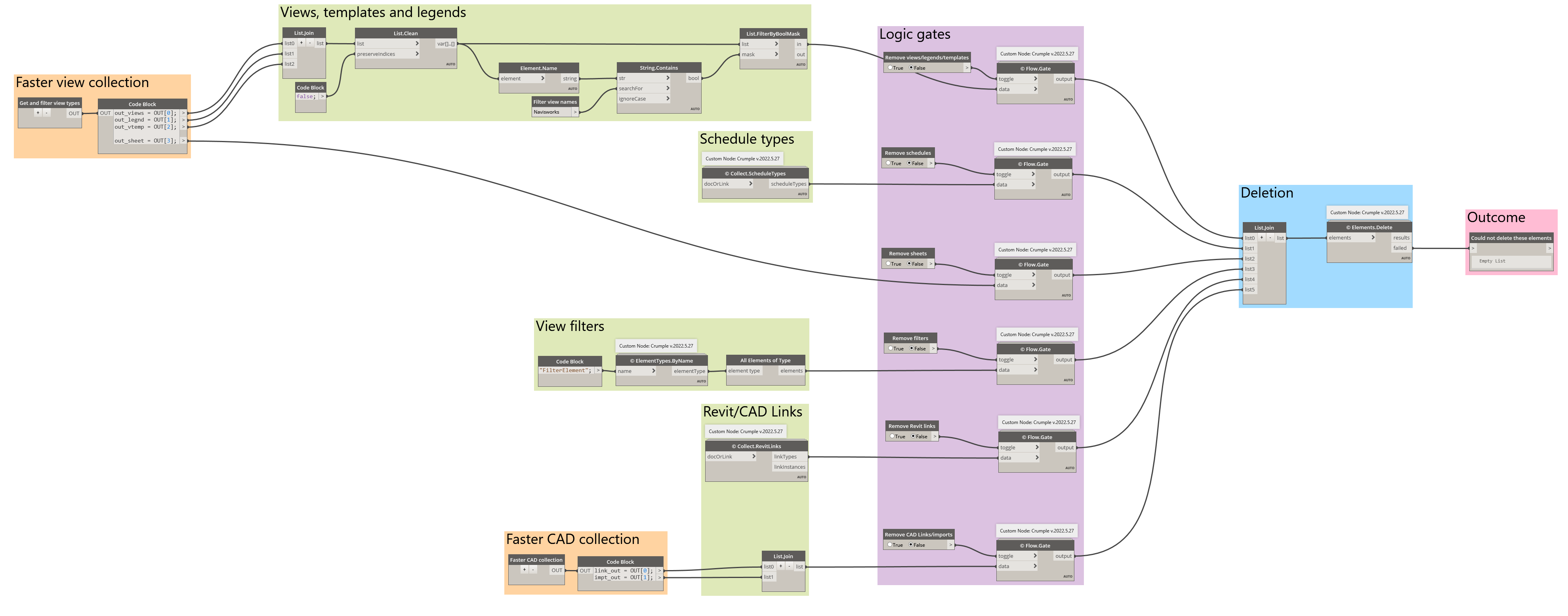

This process is much faster if you consolidate some of those nodes together (e.g. the view/legend/template collectors are all filtering out relevant views from the same sized element collector in their body), so there’s some redundancy in there when it’s all put together. This version consolidates some of the repetitive areas of the code, but reduces overall code legibility:
Purge model 2.dyn (65.6 KB)

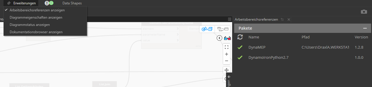

When I run the script nothing happens. Any reasons why this is happening?
Many Thanks Kieran
Three possibilities:
  1. You haven’t set the toggles to true (off by default = safer)
  2. You’re running it in Revit 2023 without the IronPython package
  3. You don’t have Crumple installed
Beyond that it should work.
