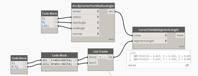

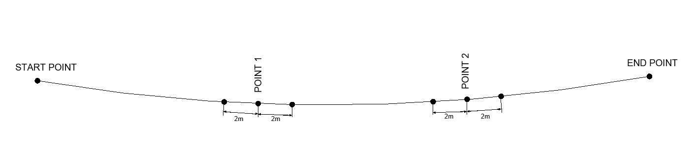

I like to offset the points along the curves on both sides as segment length (See image below)

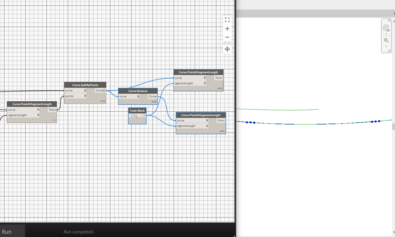

I tried with one method (See below). Is there any other ways to do without using the Curve.Reverse node.
Thanks in advance…

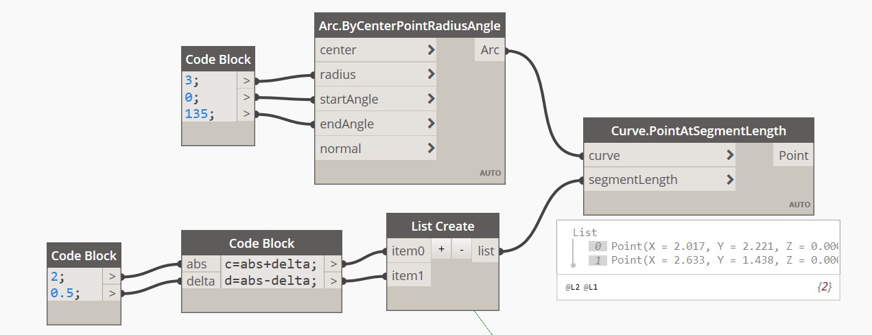

Thanks in advance…
