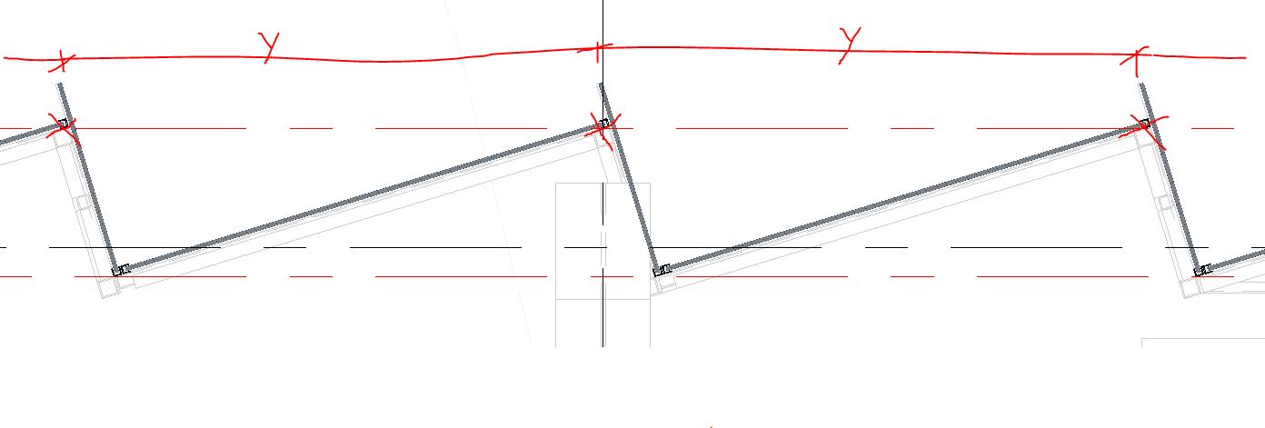

I have a vertical Sawtooth Facade(see attached plan screenshot), with each curtain wall panel comprising of one L shape (2 glass panels). I need to dimension between the points marked X(an edge of a vertical extrusion) along the entire length of the curtain wall.

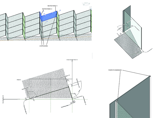

A bit more info about how the curtain wall panel was created.
Please see attached image(one panel is highlighted in blue. It contains 3 nested families(the 2 vertical double pane glass panels and 1 glass awning panel) which are generic models, and 3 extrusions which are also generic models(these are aluminium framing pieces). The dimensions i want to create will be from a corner(in plan) of one of these extrusions to the same point in the Curtain panel adjacent.
