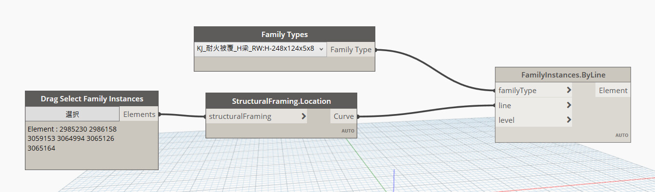

I am tring to placing fireproof covering family on the top face of beam automatically by Dynamo.
The fireproof covering is a line-based family so I just need to secelct the centeral line of the beam while doing it manually.
I tried to use the “FamilyInstances.ByLine” node but it reqiures a level but I dont know how to get the top level of the beam.
I bilieve that there are better ways to do it but I just cannot find suitable nodes. Also not familar with APIs to wrinting scripts.

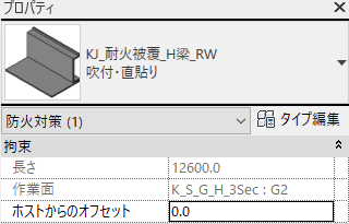

I tried Element.Level node but what I wanted to do is not associating created components with the level where hosted beams are(the 1st picture) but exactly the top planes of the beams(the 2nd picture).
I am sorry that I am using japanese Revit but I can translate that the 2nd row of parameter is the workplane that the created firecovering is associating with. I wanna let it be the beam so the created firecovering can follow the beam when its hosted beam is moved.

Well actually what I wanted to do is to host the firecovering to the beam. When I place the firecovering manualy, it can be hosted on the centeral line of the beam (which the “StructuralFraming.Location” node checks for) . I supppose to do the same thing with Dynamo.
That should be the same as what we are doing here. If not post your current .dyn a sample .rvt with two beams, one of which has the fire proofing and one of which does not, so we can understand what you are after.
