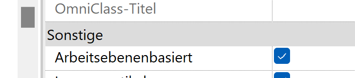

first step check your elements, that “workplane placing” is turned on. reload it. And than you will be able to replace the level.
grafik
