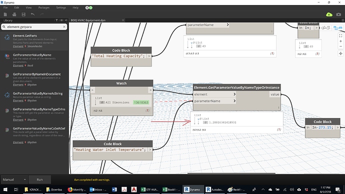

Yesterday, I installed new Revit 2019. Today i realized that None of Dynamo Element.GetParameter having right result. The Value is 80C. However Dynamo gives me 1.2881.
Please see attached photos:
Any suggestions?

Dear Alban,
But 80 C is 353 K. But it shows 1.2881. At previous version of Dynamo I was getting 353 K but now it is 1.2881.

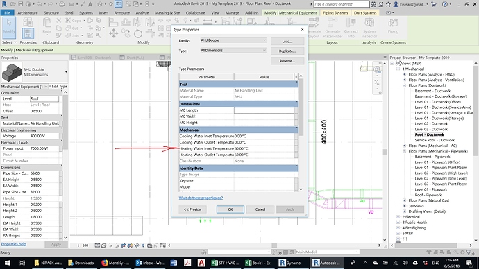

Did you check the units in revit ?
Yes. As you can see from Revit screenshot it is already Celcious. :roll_eyes:

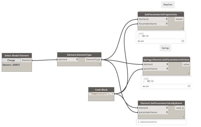

The solution will be to use Springs.Element.GetParameterUnitValue node or GetParameterAsProjectUnits node to keep the correct value in Celsius.

You have to add the node Element.ElementType before the getparameter node
Many Thanks Alban,
Worked great. :slight_smile:
