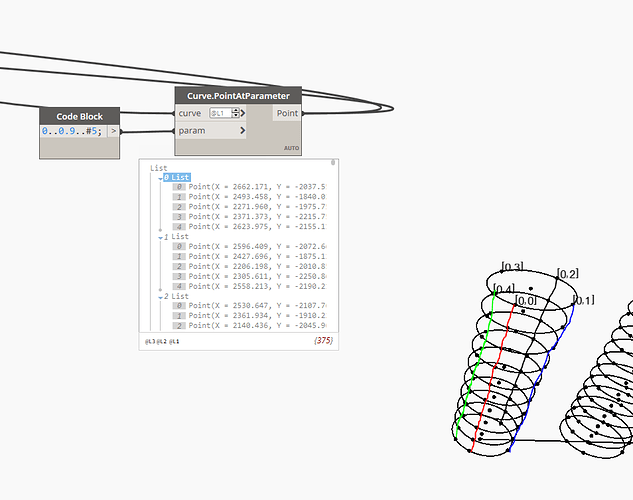

I have lists of points along with curves.
How can I pick one random point from each list randomly?
Something like that, so I can create a new cure base on those points.

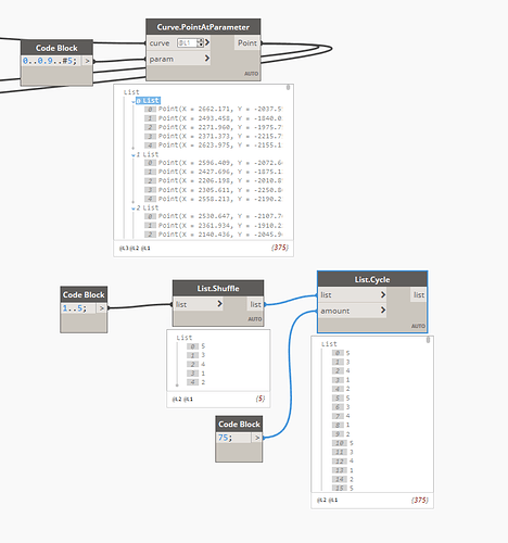

You could try Manage.RandomizeOrder from LunchBox package and connect an integer slider to the seed input choose between different random options, then get the first n amounts
List.Shuffle would work too.
Personally, if you want random than likely you don’t want to limit yourself to the curves already in use - try Curve.PointAtParameter and Math.RandomList nodes.
