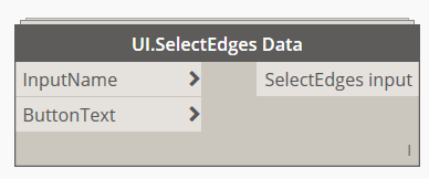

@upwallJosh, this is possible using Data-Shapes’ nodes.
I select the same edges wiith UI.SelectEdges Data and Revit select edges but they seem to be a different. SelectEdges Data appears to be wrong. Does anyone know whats going on? Or another way I can select edges with dynamo player and UI input?
